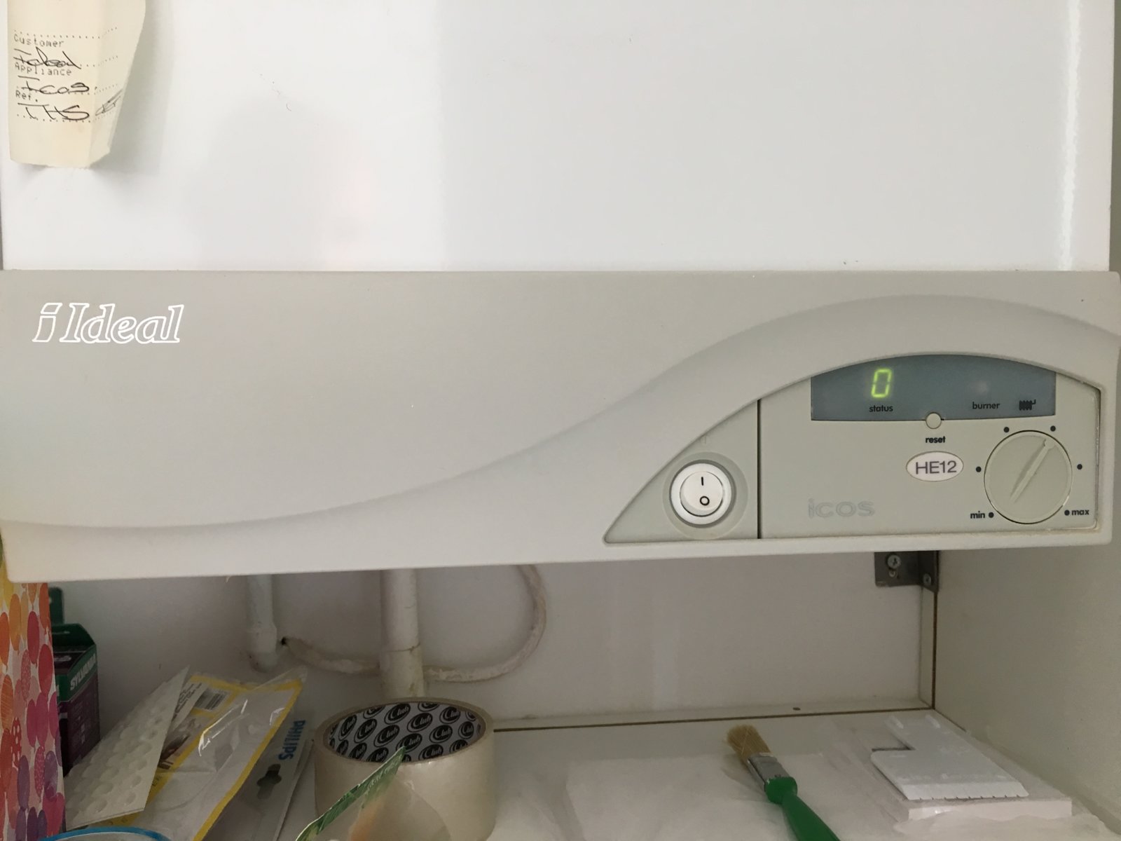

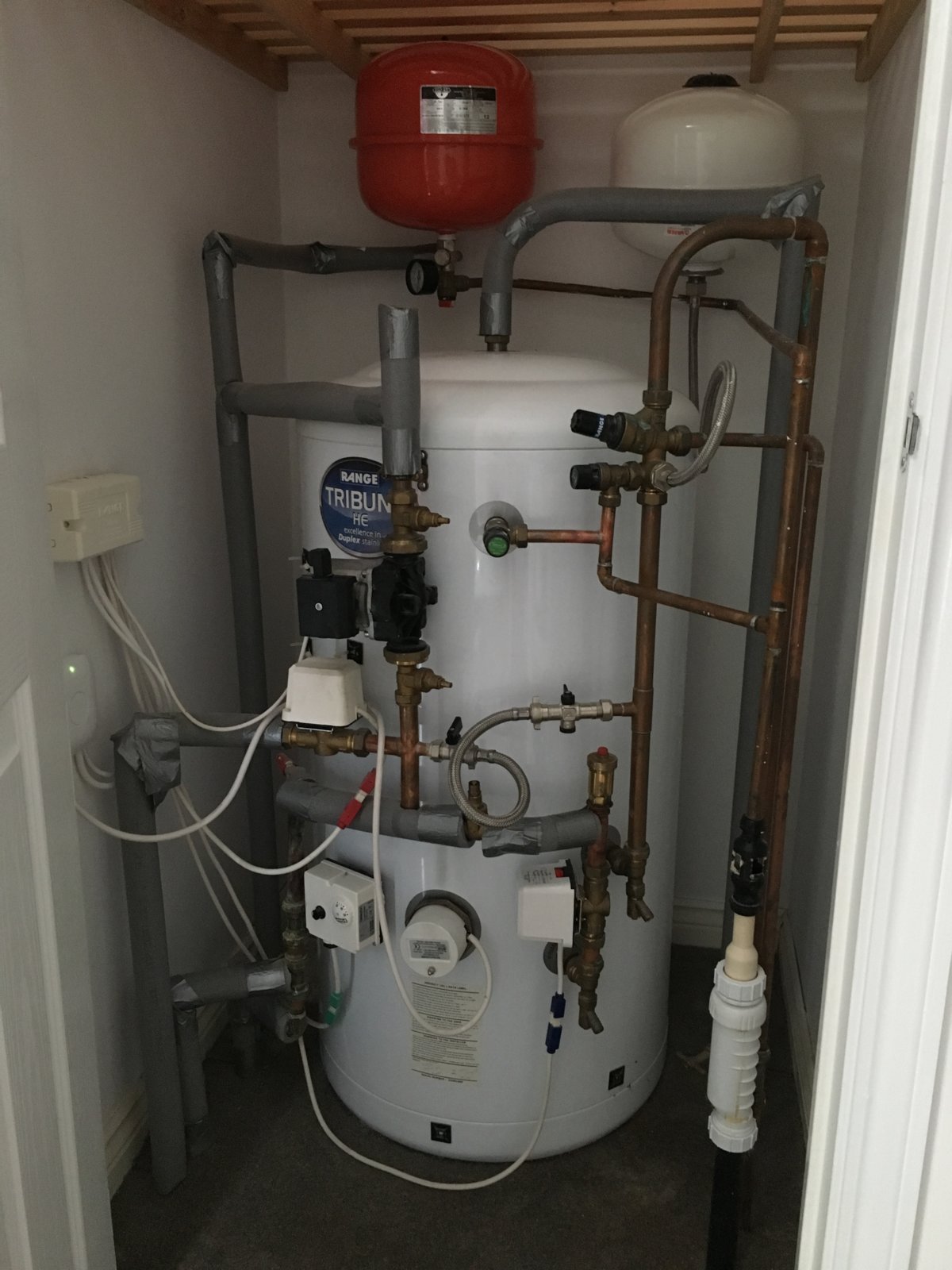

Make and model of "system boiler" please. Pics of hot water tank and surrounding pipework/valves would help to ID your problem.

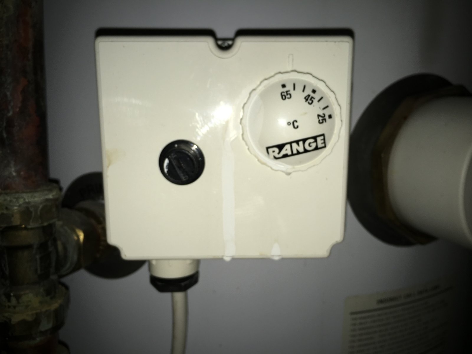

Also check that cylinder stat is securely attached and properly grounded to the bare metal of the cylinder. And are you in a hard water area?
The stat is attached securly.
Here the pics of required. The water is medium hard, in my location.

OK. So it's an unvented cylinder - I should have asked that! So scrap what I said above as its not relevant although limescale might still be.

its possible, also check no hot water is dripping through the tundish. have a look through the tundish (the black plastic item with existing scale deposits,hopefully its historical). see,feel if hot water is dripping through.
process of elimination before calling in a tech.
The cylinder should have a service record :)

What temperature is your boiler stat on? It needs to be higher (IME with my Vaillant, by 5-10 degrees) than the cylinder thermostat. You can do a cursory check on the cylinder stat to see if it's working by listening for an audible click when adjusting it - try turning it down slowly once the boiler switches off after heating the cylinder up, you'll probably find it's slightly too high to prevent the boiler cycling. If that's the case, either turn the cylinder stat down a bit or turn the boiler stat up a bit.
A more thorough check would involve checking the outputs of the cylinder stat and zone valves, but you may be better getting a professional in if that is necessary, as unvented cylinders have a number of safety elements which require a G3 certificate to have work carried out on them.
One thing to try is to turn the hot water thermostat down by 5C, then observe the boiler operation. In my experience the output temperature from the icos boiler is only about 65C when the knob is in the position you have, so it's possible the cylinder thermostat doesn't get 'satisfied'. If this is the case the boiler will display 'c' and cycle as you have described in your original post until the hot water timer switches off. When the cylinder thermostat becomes satisfied and all else is well, the boiler will display '0' after about 2 minutes.
So if that works, and you like your water hot, then turn the cylinder stat back to the setting shown in your photos and turn UP the boiler temperature by about half a division. Be wary of going much higher than 60C, as rapid scale formation will occur. Likewise beware going less than 55C to maintain protection against legionella growth in the hot water system (unless you can maintain a weekly regime of heating to 60C).
PS, that icos is a 'regular' boiler, not a system boiler, their system boilers have the pipework exiting the boiler at the bottom, and they only made the system boiler in 15kW and 24kW sizes.
