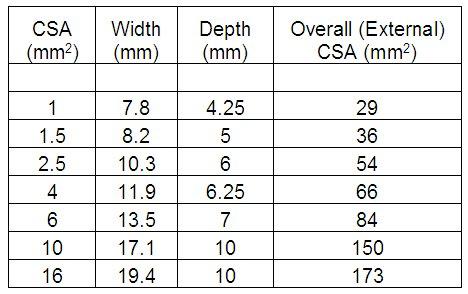

Where can I find the cross section area of the cables to assist in calculating space/filling requirments of the (oval) conduit?
External sizes of cables vary a bit, but approximate external dimensions are given in the forum's wiki click here , from which you could attempt to calculate/estimate approximate external cross-sectional-areas.

MK helpfully list cross sections of oval conduit here, but I can't find any corresponding tables anywhere dealing typical cross section areas of flat T&E.
If one takes the 'typical' external dimensions of T&E from the forum's wiki (which I mentioned before) and assumes that the shape is such that the cross-section can be represented as a rectangle with a semi-circle on each end, then what one can calculate is as follows:
However, guidelines in relation to CSA's is obvioulsy only part of the story when deciding what cables will even fit in what conduit (particularly if oval)!
