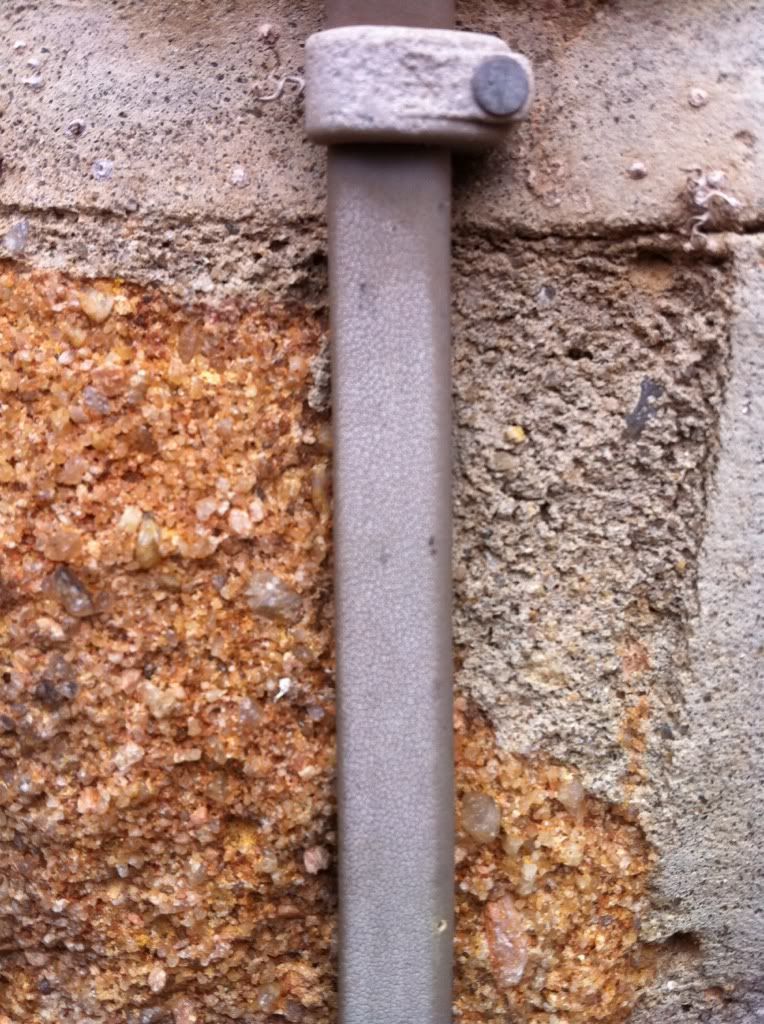

We all know twin and earth should not be used outside. However the grey colour was to emulate the orignal lead that this was made with and that would have been OK outside and of course covered in earthed lead it would have been very like the Ali-tube cable we use today.
The plastic twin and earth is a cheap cable and I have only seen it used in domestic. Maybe shop fitting as well but you would not find it on the factory floor.
I would like to see Ali-tube replace it but price is the problem. It's cheap and nasty like many domestic products.
I've seen that too - it's probably been up there for 30 years. It'll be fine under the cracks.
Unfortuntally you do see it on factory floors these days, often with inadequate protection against damge for the location in which it is installed.
And it is now a main-stay of commerial instalallation, whereas in older installations it would be trunking and conduit. More often these days its basket tray above the ceiling loaded with twin and earth. Theres are pros and cons of it, but I suppose its easier and cheaper to install, easier and cheaper to modify and thats why its done
Quite often come across flat grey t&e or even three core & E, used on outside lighting. Some I have seen has been in place for years with very little adverse effect.
Was recently working on a newish built estate (built in last 10-15 years). Some of the external lighting looked like it has been in place since construction of the house and all run the same on each house, in flat grey t&e.
