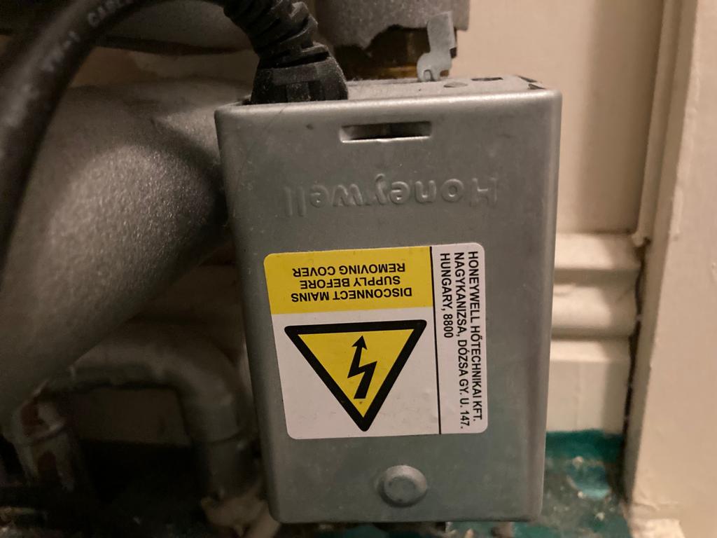

I'm guessing the valve is the box in the attached photo? How can I tell if the valves are activating, just by listening to it?

Yes, and an easy way is move the lever on the side when a demand has been set, resistive - not working, no resistance - likely working.

I'll check the valve when I go round in a couple of days. If the valve is not activating what would be the solution (I believe that the valve was replaced last year so it isn't old and was working fine before I fitted the Tado).
I read a post on the Tado forum which is similar to my situation and they were advised to try moving the CH NO wire to the Parking P1 - would that be likely to have any effect? I was thinking of trying the CH NO to CH NC - not sure if that would do anything either.
No, parking terminals are just that, for parking unwanted terminals. Normally closed, is rarely used. It’s either a wiring fault or zone valve fault.
as it is an s plan would be unusual for both valves to fault at the same time, more likely you have wired something wrong, I would be checking the neutrals to the zone valve motors
Looking at my photo of the extension wiring it does look like one of the neutrals could be seated better, but pretty sure it's making contact. I'll sort that first and then look at the valves.

As already said the bleed levers on the motorised valves go slack when activated so you should be able to work out if the valve is operated
