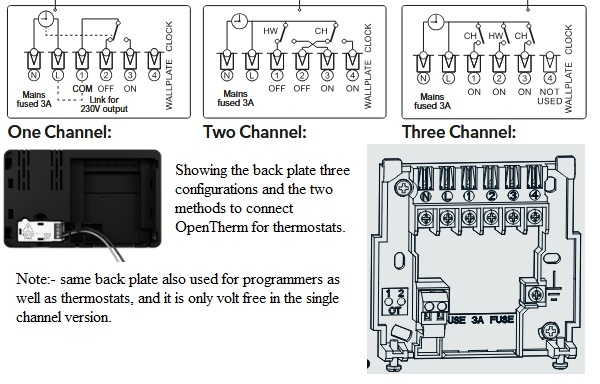

Thanks both, the only way seemed to get some improvement was swapping the blue to channel 4 and the yellow bit to 2. But boiler heats up then but nothing to radiators.
