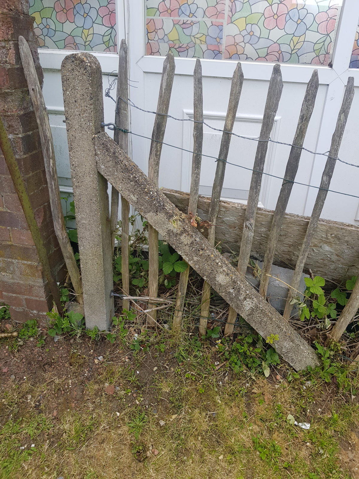

Hi guys. Im thinking if putting a fence up but need to get rid of this concrete post first. Any idea how far deep they go and wether they have any concrete block underneath?
Or any suggestions?
Probably about 12" and a bucket sized lump of concrete under each post.
Easiest way is probably to separate the vertical and angled post, then wiggle each post like a wonky tooth and pull the entire thing out like a tooth. What may help is excavate around it with a trowel, allowing movement, but over a couple of days chuck a couple of buckets of water into it.
I had one where I had to use a kango, because a nearby post's concrete had blended in with the older one
I once used an engine hoist to lift a post straight out prior to enlarging the hole and then replacing with more concrete.
If you don't need to put a post in the same position you could angle grind it as low as you can.
If you are intending putting a new post in its place, then I would be trying to dig down the side of the concrete plug it is set in. at some point you will be able to wiggle the post and its plug out all in a oner.
