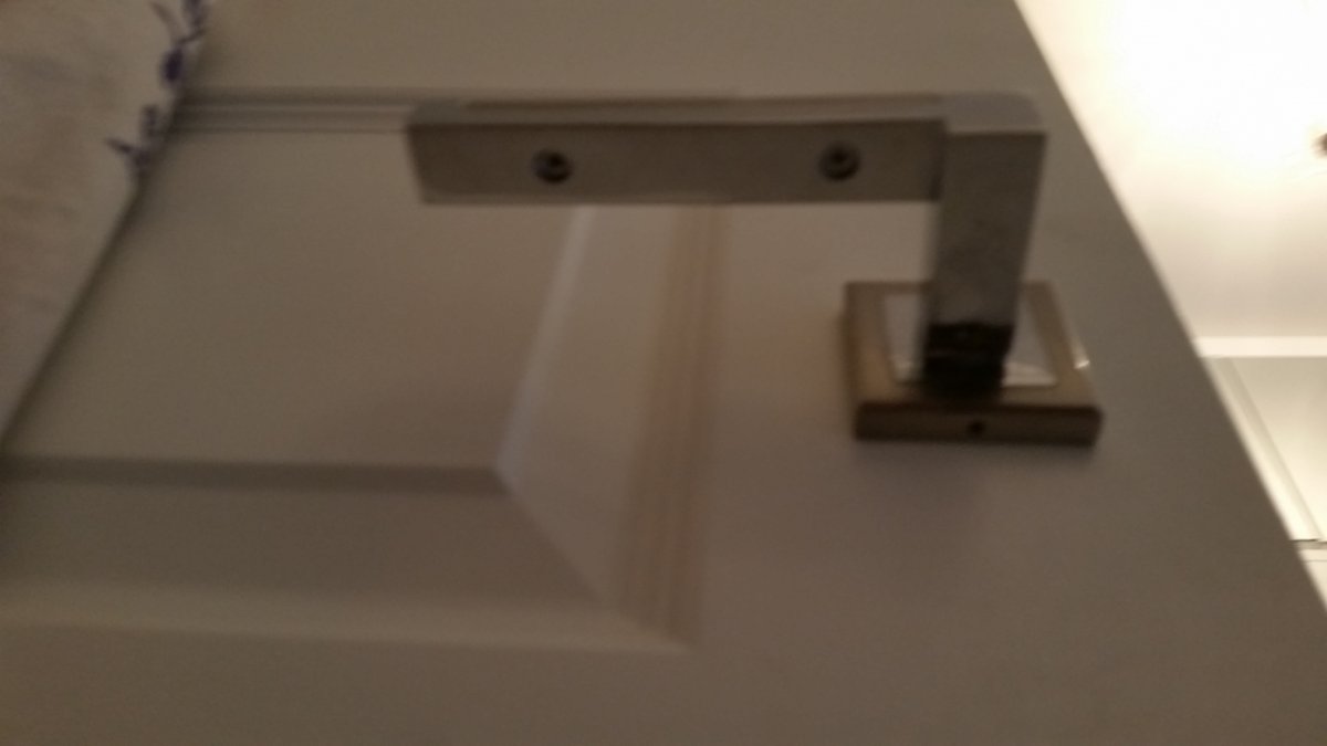

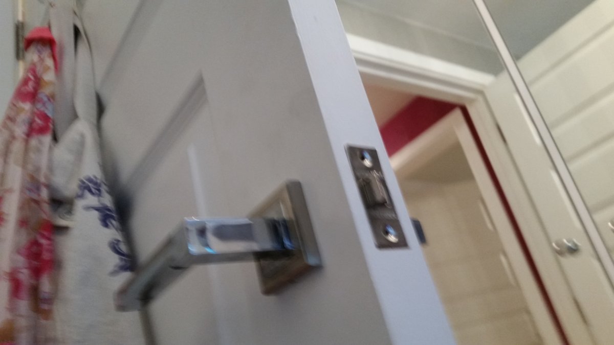

How u get these off? Is it the star shaped screw on underside (not sure if u can see it, it's near the door) or the 2 big pozi screws on the door end? Need to take it apart to put grease in.
The pictures out of focus, but I think you'll find a small hex screw on the bottom of the facia plate.
Yeah there's a tiny one on there and bigger one on the handle. Just unscrew that tiny hex screw and the whole handle will come out?
the one on the handle will probably take it off the spindle/backplate and the one on the faceplate will probably release that from the backplate which will be screwed to/through the door
