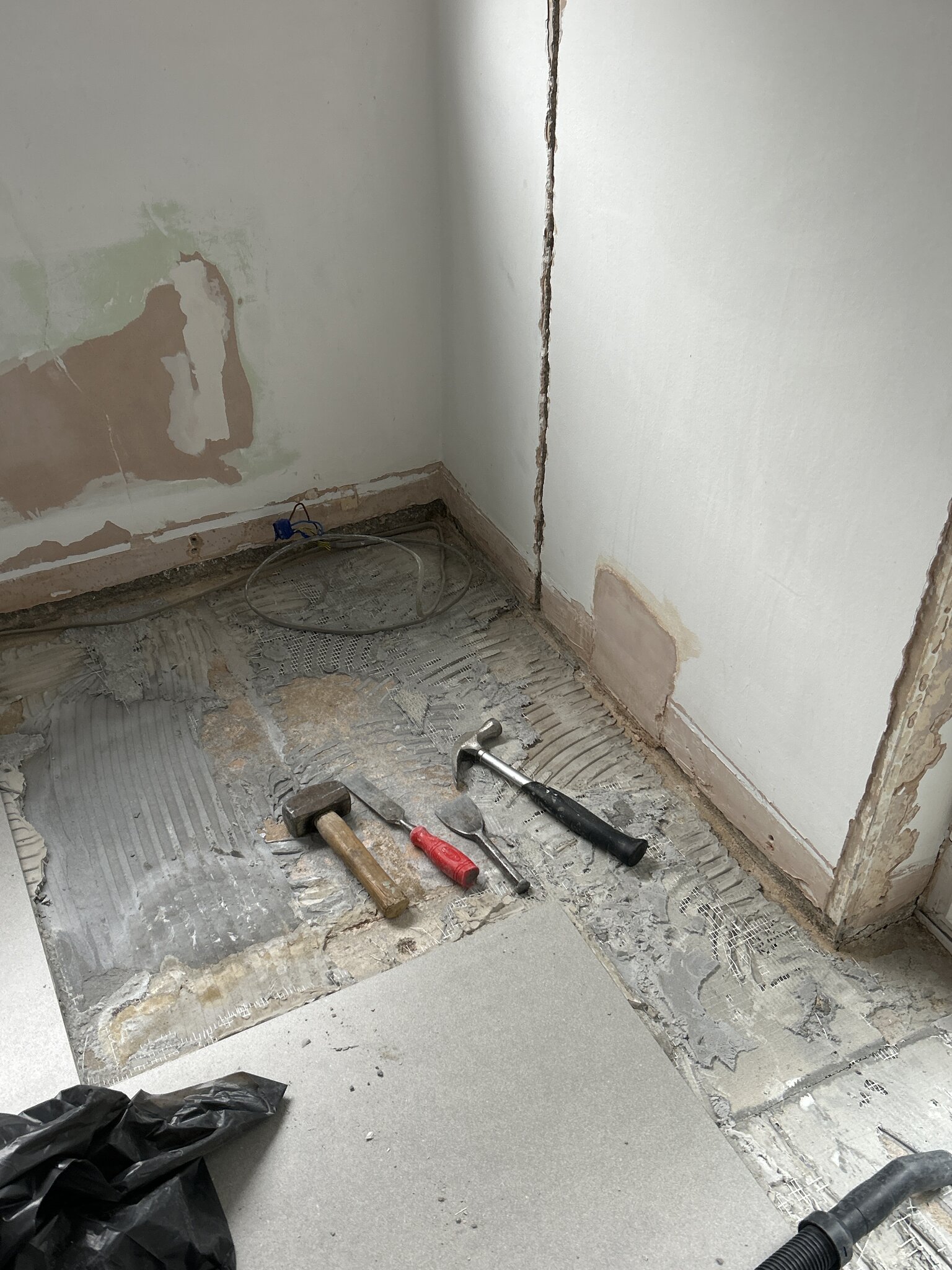

I need to renew my kitchen floor tiles as they have cracks. I have been using the tools in the photo to get up the tiles. It’s not too bad but there is a lot of tile adhesion left which is difficult to remove. Does anyone have any suggestions what will make this easier for me. I have a hammer drill if that helps
An SDSdrill with a tile lifting chisel is quickest, They work a treat especially if you have a variable spped drill so you can tune drill to tile..
I also use a home made one, made from a bolster (longish shaft best). I cut 2/3 through blade with my angle grinder and bent the blade over. You don't need to go far, just enough to let your knuckles clear the surface with the blade flat on it. Then weld up the groove and grind the top of the cutting edge to a single vee with a nice shallow slope. It works a treat.

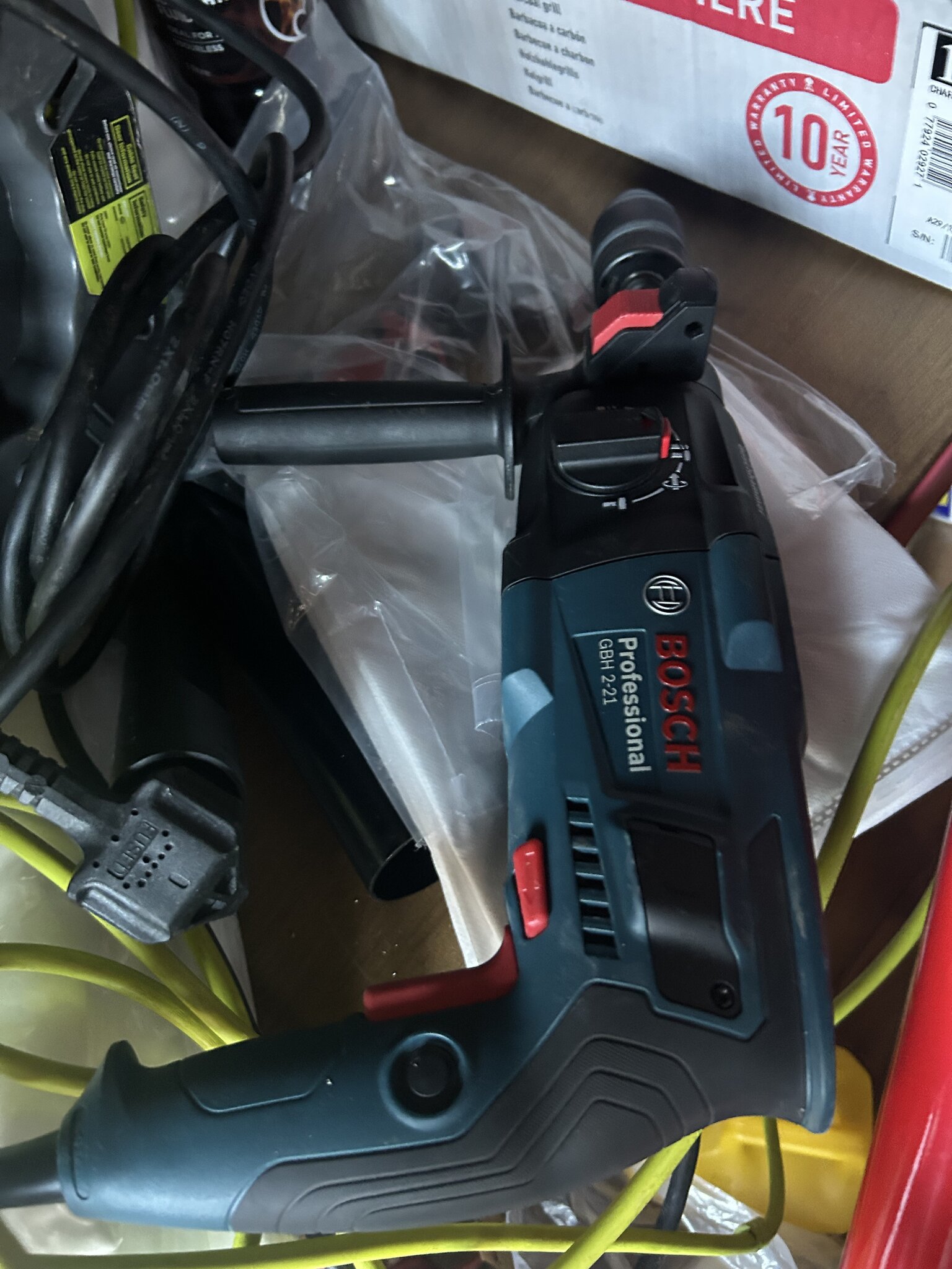

I only have a hammer function drill will this be ok? I wondered if it is necessary to remove everything back to the original concrete floor? From the left hand side of the photo you can see some tile adhesive sticking out from under one of the intact floor tiles and it looks like a completely different colour to the darker grey bits I am trying to remove. I wondered if the darker bits are a screed and if this still all needs to come up before fitting new floor tiles?
That looks like a normal hammer drill with a conventional chuck. It will drill (wood, metal etc) or drill plus hammer (masonry, concrete) but it won't hammer only and that's the function you need.
That drill does have a hammer only function. They normally come with an SDS chuck as standard and you pop the other chuck in
for standard drill bits. A bit light for the job in hand but better than a hammer and bolster i suppose.
No, it’s an SDS drill. I have a similar one. Great for drilling stone and brick; a bit light for demolition but it does have a hammer-only setting.
The old mincers aren't what they used to be, but good for the OP
Great. I’ve just ordered a tile remover attachment and floor scraper, can’t wait to use it. Thanks to all of you, made the job so much easier for me.
