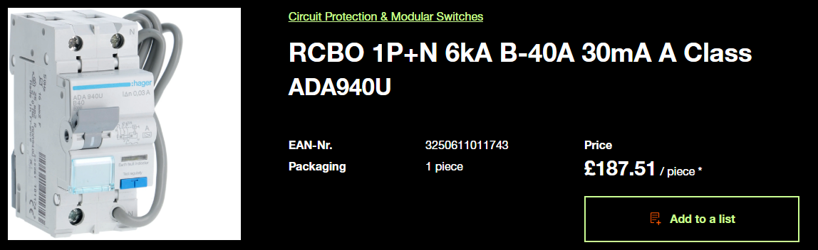

In a good few cases, it's not clear from a seller's information as to whether a n RCBO is SP or DP (and the same even seems true of some manufacturer's information). It also seems that some manufacturers do both SP and DP compact RCBOs (and sometimes also SP 'tall' ones) - e.g. Hager 's SP compact RCBOs can be had for under £14, whilst their DP ones seem to cost anything up to about £30 - but then what on earth is this 2-module animal (with an 'interesting' price!) I found on the Hager website? ...
