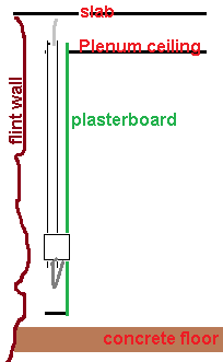

We are being tasked with the wiring while a Tanked cellar is being re-tanked and refurbished.
Basically the studwork for the walls has rotted and some blame is being placed on the existing wiring touching the tanked surface and allowing moisture to bridge the gap...
Realistically it is just hanging in the void so may very well be guilty to some extent.
My suggestion is running plastic conduit on the new studs before the plasterboard is fitted and plasterboard back boxes.
Any better ideas?

This job is a very uneven flint wall and will be drylined and ventilated with nothing touching the walls and all services hidden.

The rotted lining was mounted snuggly between the floor and ceiling so effectively sealed, the replacement wall will be fitted with a gap at floor level and finish inside the new plenham ceiling to provide the ventilation. Nothing is to touch the flint wall, the only thing that could before was the loose fitted cables, hence the initial reference in the report.
Our remit is only the leccy and I'm looking for others thoughts on best practice.

No nothing will touch the tanking at all, I have seen situations before where fixings have been drilled through the tanking and the water then drips from the fixed item.

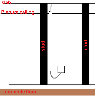

The lining wall will be 4x2 timber and plasterboard, fixed only top and bottom. My thought is to fix plastic conduit to the studs which could help with any future alterations but this is surely not a rare situation and I wondered if others had a better idea.
Thanks, I've received a PM suggesting using metal saddles for the conduit as the plastic versions can get brittle.

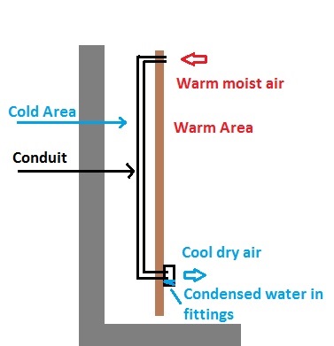

With vertical conduit in the cold area between tanked wall and stud wall condensation in the conduit has to be considered.
The cold area cools air in the conduit and convection currents occur. In worse case situations drain holes at the bottom of the vertical conduit runs may be necessary
I was thinking more about leaving the bottom of the tube open but that's a good point you've raised, any condensation in the tube would drip onto the bottom rail of the studwork.
Originally we were going to clip cables down the studs but I like the idea of the tube for future alterations/repairs.
The cold area cools air in the conduit and convection currents occur. In worse case situations drain holes at the bottom of the vertical conduit runs may be necessaryView attachment 150837
