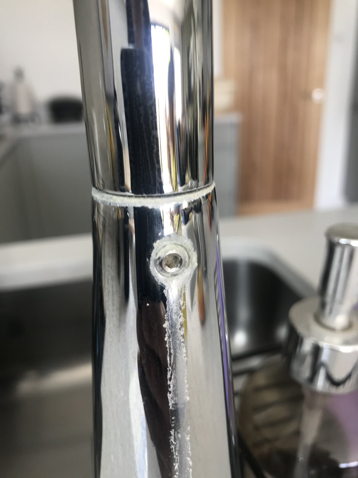

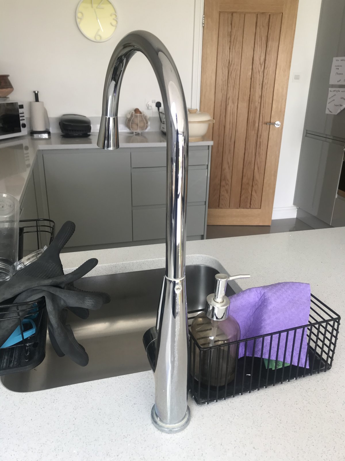

Hi All,
Hope you are keeping well.
I’ve noticed my Bristan Tap has started dripping from this Allen Bolt (from appearance).
Can someone please provide an explanation for this and also a solution?

From here I would say it is leaking from the swivel joint just above the screw rather than the screw itself. There is probably a rubber O-ring there which at best needs cleaning and at worst replacing. See if you can find an exploded diagram of the tap and if the ring is available as a spare part.
1. The seal(s) which prevent water escaping from the swivel base of the spout have deteriorated.
2. Replace said seals. Install with a smear of silicone grease.
3. To access seals, remove Allen grub screw (don't lose it), and pull spout upwards and out.

It’s one of those quick change taps which just needs a Allen bolt to be removed in the event of replacing the tap. It doesn’t sound like this should be necessary.
The water does appear to be sleeping out of the Allen bolt but I suppose it may be just above it. Difficult to discern.

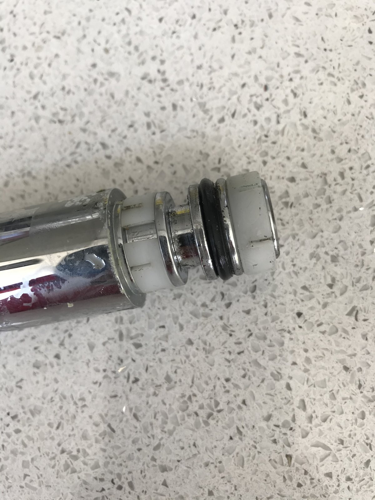

Hi Guys,
I just unscrewed this and this is how it looks. It doesn’t have the washer I was expecting. Any ideas on what needs to be replaced?
Thanks again

Bristan have a good spare parts section online. Look at yours and see if the Exploded Diagram shows a seal.
Is that a rotating joint, or is it fixed?
The top half of the tap rotates. This is the section in the picture
then LSX no good. PTFE tape will work for a while, until it wears (is OK on rarely-used stopcock and lockshield spindles)
I'd have expected a rubber ring, and white silicone grease.
