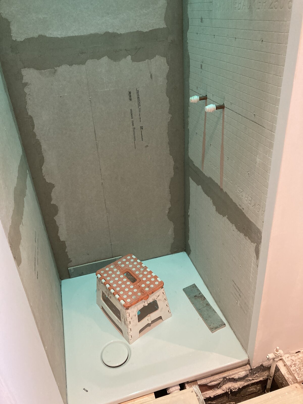

Your first ‘version’ is correct - Buy the tanking kit, paint it on. Use the tape that comes with it to go over the seams/joins. No need for any preformed corners or CT1 etc.
When I've done ours I've used the hardiebacker tape and then trowelled on some tile adhesive over the joints as you say.
I've not used the Mapei one. I tried the Everbuild kit which I thought was rubbish. I can certainly recommend this one though and it comes with two corner pieces.
https://www.protilertools.co.uk/product/tilemaster-tanking-kit-waterproofing-tub

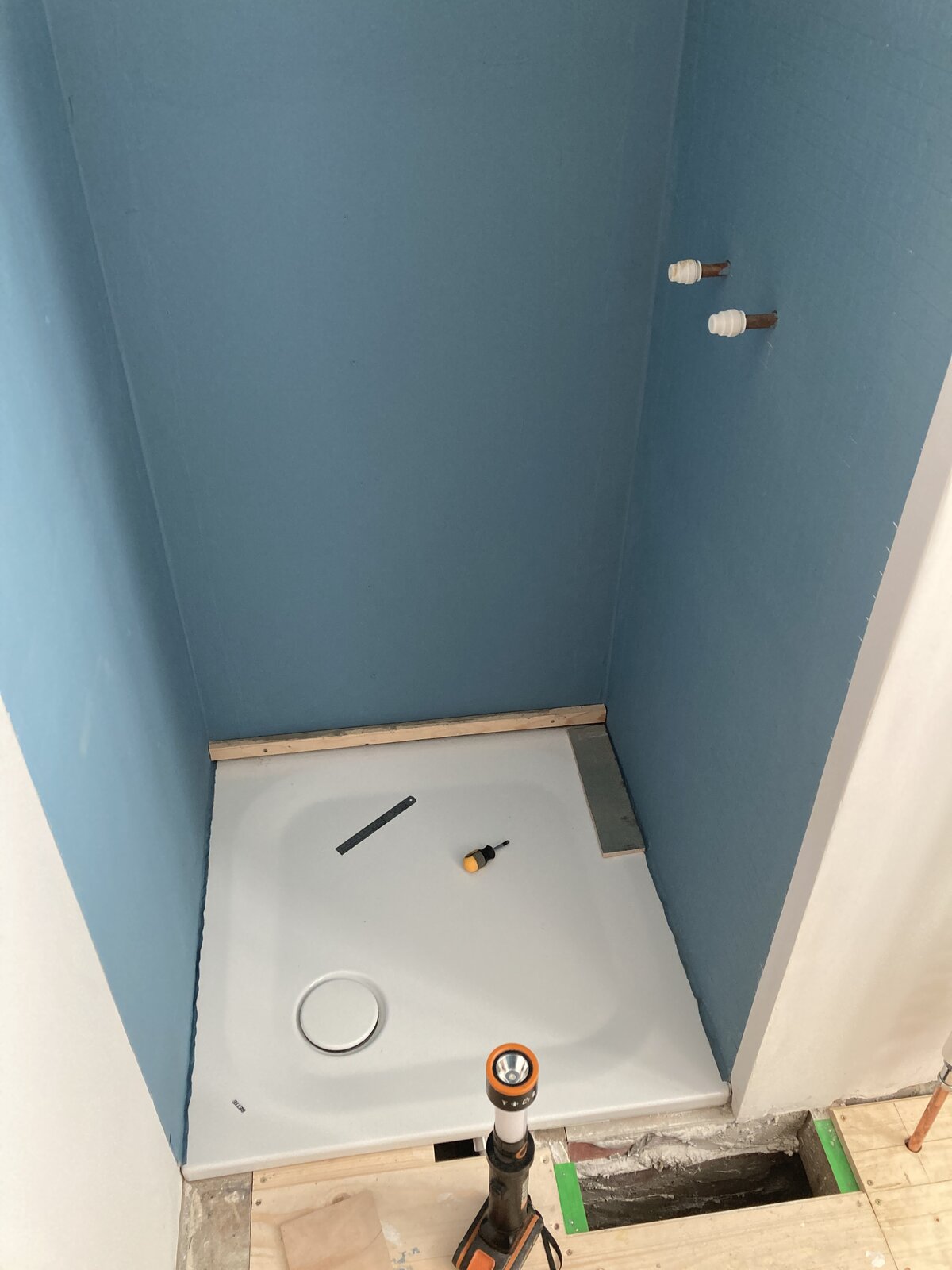

Use the paste and then apply the tape/corner pieces, then you can go over them again and apply everywhere else. I've always done a small overlap with the tape at the bottom, over the tray edge.
