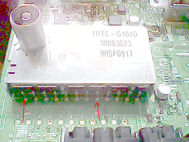

LCD19-910 model
No signal for TV in the menu. I had the TV back off and tested with a meter.
From the edge of the pcb, pin 1 has continuity to the center pin and the socket barrel has continuity to pin 8.
I've tapped the row of pins with the soldering iron in case of a dry joint but still no signal.
Any ideas for further investigation?
The Roku stick on the HDMI is fine.

Before rushing to assume hardware failure, check in the menus/settings that:
it's the correct country selected
it's digital and not analogue
it's antenna and not cable
and auto channel tuning has been done with those correct settings.
If some/all of those are not available, then factory reset the TV and set up as if it was new.
and obviously confirm that the cable being connected is really connected to something that is providing a usable signal.
Have already had an aerial cable plugged in when adding the cable to the aerial. It did work but not now.
Have tried the TV on the wall socket/cable I know works yet 'no signal'.
There is a TV reset in the Picture sub menu, just reset with the OK but not bringing the aerial feed back to life.
Its a Freeview TV.
Apparently the reset is standby, info, menu, mute, standby pressed in that order but it hasn't worked for mine.
LCD19-910
The DTV/USB option had disabled itself in the source menu. My Toshiba freeview TV has the TV source option but no DTV/USB option so presumed it was the same source needed on the Technika TV.
With DTV/USB enabled again, all channels are loud and clear.
