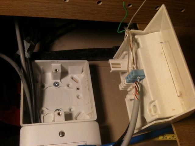

Hi There all,
I have my phone line coming straight in to my socket (there is nothing in between). I bought an "ADSL nation" XTE-2005 (I think that is what it is). It has the following connections:
2, 3, 5, A, B.
The electrician left me a cable with four coloured wires:
White, Brown, Green, Black.
After some tinkering I found that if I connect it up as follows both my phone and broadband work:
Brown -- A
White -- B
Nothing else is connected at all. So I lived with that for a while, but then I wanted to move my phone to a different location and leave the adsl where it is. So I run a second cable connected to A and B to where my phone is and connected that to a remote socket, and this also works ok.
However I have no idea why! So my questions are:
- Is correct?
- Is this causing unnecessary noise on my system?
- What are 2, 3, 5 used for?

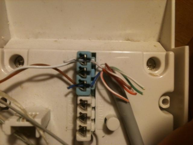

Finally my adsl nation fixture does not fit my wall mounting because the wall mount is flat and the adsl is not flat back and has slightly different screw fixings. What do I need to do to attach it to the wall nicely - is there some spacer I have to buy?
Pic 1 shows my wiring. You can see the Brown and White wires coming in from the "outside" world, and then my "extension" wire (which is just an ethernet cable that I am using 2 of the wires from) is also connected to the same connections A and B to my phone extension socket elsewhere in the house:
Pic 2 shows my wall mouting and the ADSL that don't fit together : (
Thanks very much for any pointers.
The standard extension uses wires 2, 3, and 5 so it would seem likely that's what you need to do.

I am confused as to your setup. Your incoming phone line should be terminated by BT Openreach to an NTE5 socket and the only connections you should make to this is extension phones to terminals 2,3 & 5 on the removable front plate. You can get a replacement filtered front plate which allows you to plug in your phone and an Ethernet lead for broadband. If you need to call out Openreach to a fault and they find non standard wiring you may well get a big bill.

After doing what? Where has the original master socket or other connection box gone?
If this electrician removed it, then it is up to them to pay Openreach to fit a new one.
A&B are the incoming line, generally orange and white.
The green/black pair would be used for another separate line if you wanted one. As you only have one line, they are not used.
While buying a master socket from ebay and fitting it yourself may resolve the issue, the real question is why it was removed in the first place.

Without doubt diyfodder needs to get the builder to rectify the bodge he has created. While it may work at the moment if there is ever a need to report a fault on the line then OpenReach will discover there is no master socket ( the lack of capacitor and inservice resistor will be detected ) and an expensive call out will be needed. DIY ( non OpenReach ) wiring connected directly to the incoming pair ( other than by plug and socket ) is a no no and it is likely that no amount of tea and choccy biscuits will swing the OpenReach technician.
Electrically much the same as a standard setup if you put your extension cable into 2 and 5. However, the cable the electrician left your line on looks like cheap stranded alarm wire, not to bt spec. If so, it wont make a firm connection in the idc terminals and the quality of the wire itself isnt good enough. Could be knocking your speed down substantially. Will need to be re-ran in proper bt spec cable.
