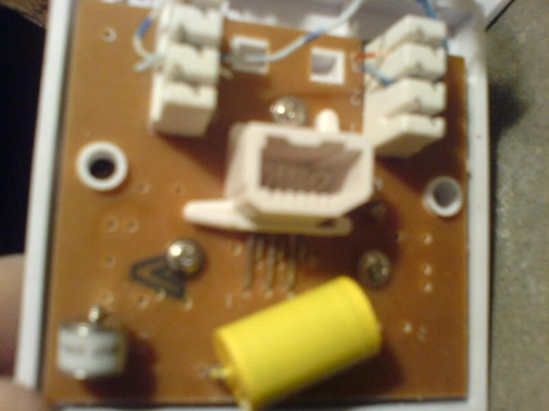

well following from previous advice I went to QVS and bought all the bits and wired the flat up for a couple of phone extensions. then i came to connect up the master (was only bare wires coming into the property) . . .expecting to find a couple of screws inside the master socket I instead found this:
http://i133.photobucket.com/albums/q62/theflyingpig/phone.jpg
OK - so its definitly a master?
Are those little screws the ones I should be connecting to BT wires too? they don't appear to be labelled - and there are three of them!

Yes that is a master socket you can tell by the capacitor, it is not clear from your pic but there should be another cover in the box that the socket screws to, under that cover you should find the terminal block where you connect the 2 wires you have.

looks good to me, the master tends to have a big diody thing (tech talk 101) but the master only needs white n blue and orange n white.

put the O/W in 2 & W/B in 5 on the left hand side terminals (top and bottom as you look at it from the back
If you take the socket topieces you will find two screws these connect to the outside line You only use two wires you have more in case you have more than one line. A pair is wires almost of the same colour. If you have a meter look for a pair of wires with 50V DC on. Thats your phone line connect these to the two screws. You should have a working phone line when you plug in the front.
