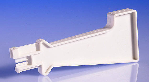

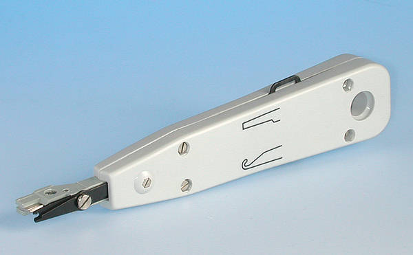

If they are push fit how do I connect the new spur wires?
cheers
D
With an appropriate IDC punchdown tool of course....
