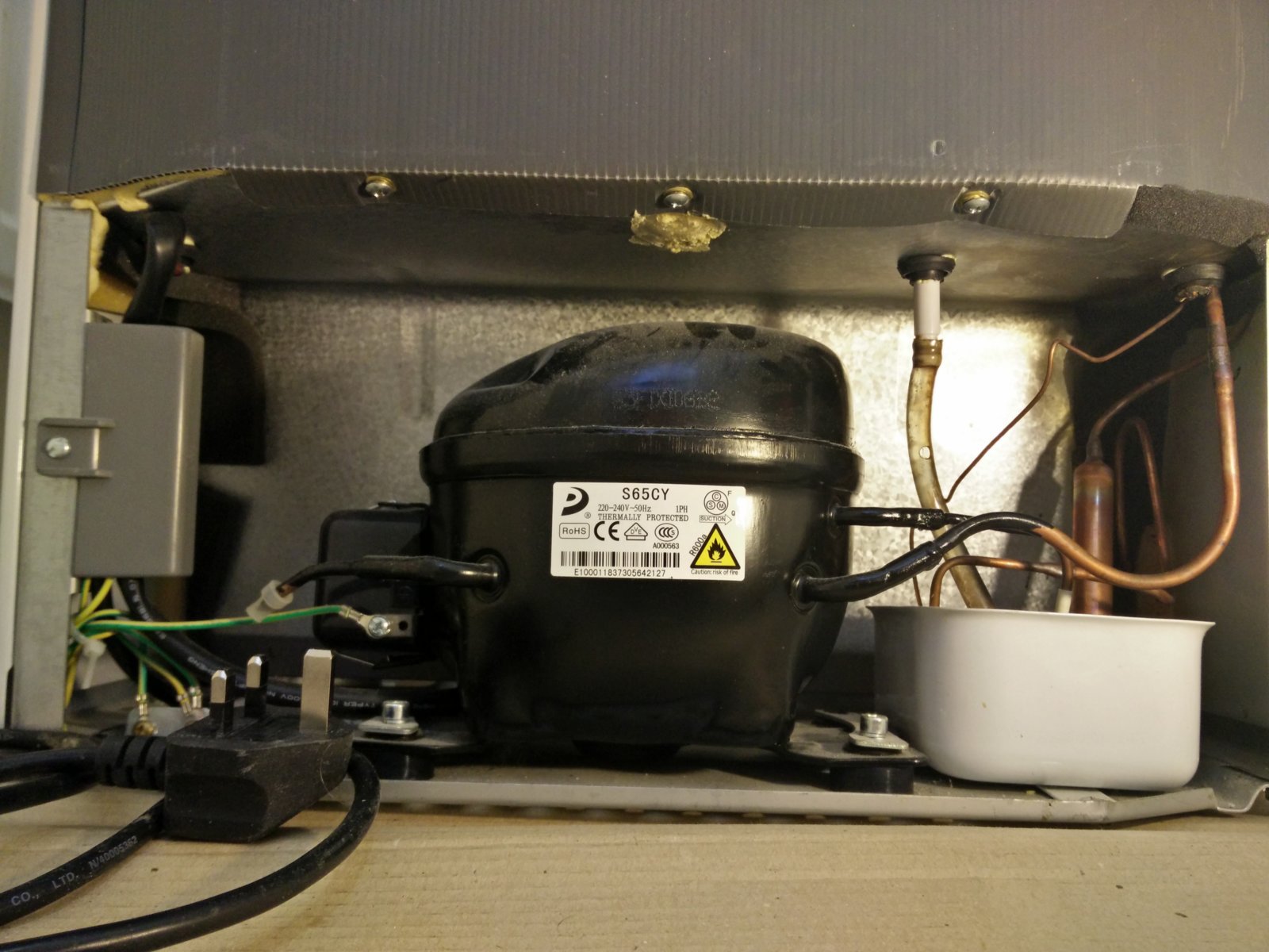

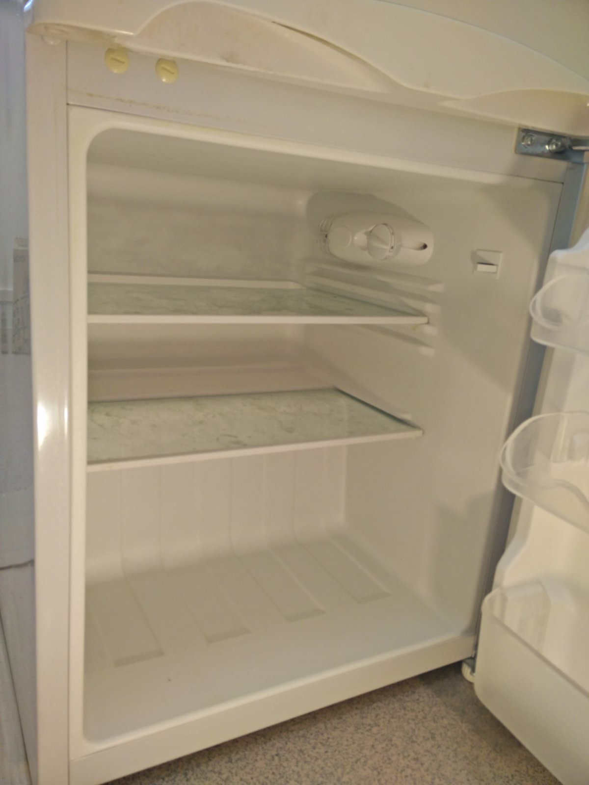

I do not know what is the "thermostat probe", I am going to show you the photos of the front and bake.

Hi,
Is this the thermostat probe you mentioned?
Can I replace this by myself?
Where I can buy one to have a try?
It must be internal to that plastic molding surrounding it.

So where do you turn it to make it stop cooling? if your turning it fully down, have you tried half way?
Are there numbers around that knob or is it not fully seated in the hole? it may not be on the thermostat knob properly.

Are you able to disconnect the power, unscrew that plastic housing covering it (the knob should pull off) and identify it by the writing on it?
