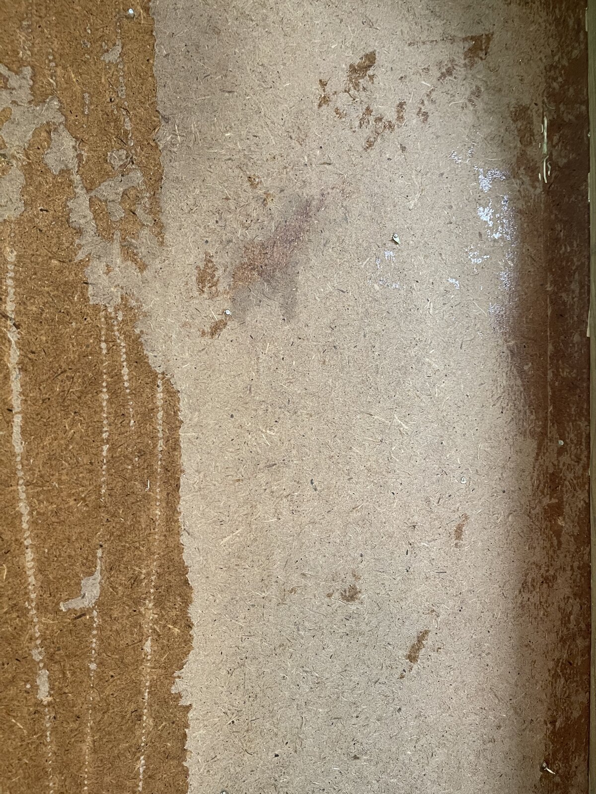

I have removed old wallpaper and found the wall is made of hardboard with a sticky glue that won’t come off ! I’ve used all kinds of Strippers, etc. What can I use to get off my walls so I can paint! Please help!

Can I prime over glue?

Trying to prime over any adhesive is potentially going to fail. Ideally you need to either get the adhesive off, or possibly consider covering it with something else (not a paint or a primer). You have already tried solvents and failed, but have you actually tried removing it with water or a water- based product such as sugar soap or soda crystals? Substances which don't dissolve in petrochemicals will often dissolve in eater or water + a detergent.
BTW, that material looks more like chipboard - hardboard and masonite have a very consistent texture and lack any wood splinters or coarse fibres. Rather a strange choice for wall cladding.

Sugar soap - try a decorator's shop or the paint isle in B&Q, at Screwfix, Toolstation, etc. Very widely used in decorating
