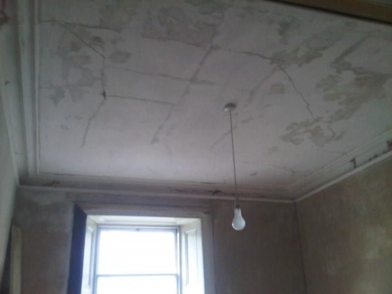

The only thing I'd done up to last weekend was sort the lock on the front door. We've now tackled the main bedroom by stripping the old wallpaper and scraping the ceiling. All was washed/scrubbed before a first coat of emulsion, just to get a base. Most of the patches in the ceiling are bleeding through so I'll need to seal those, possibly having to coat ceiling and cornice with oil paint.

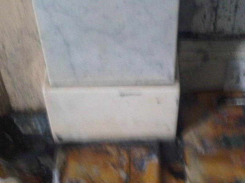

The first fireplace is almost stripped but looks like it was made from marble of different colours. The pic below shows a base piece that is creamy compared to the grey upright. Stripping the window is taking longer than I would like but the grain looks good (I think it's pine).
It will be worth the graft if you can get it all back to bare wood!
