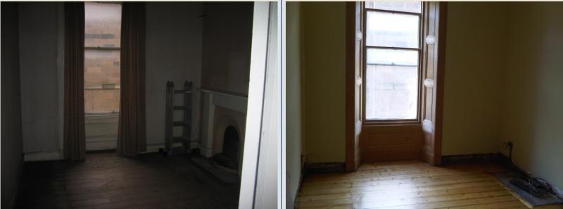

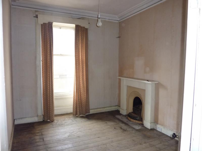

Before
Fairly straightforward to begin with - strip walls/woodwork, prep all surfaces, decorate. New electrics to be installed by electrician.

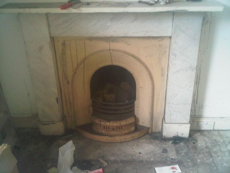

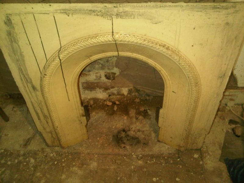

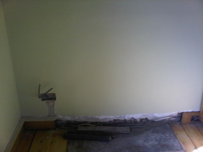

Stripped fireplace back to original marble but not keen on the result (not all pieces were the same shade). Decided to remove to give better use of space.

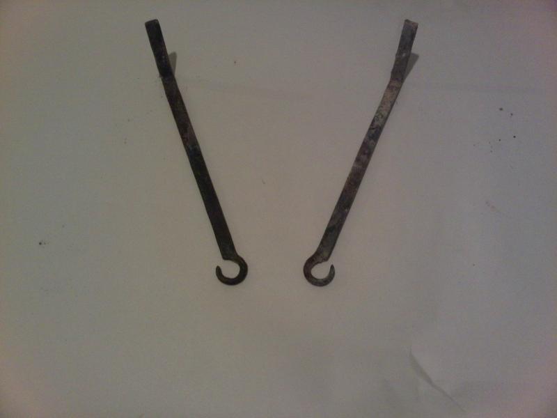

Inset was held in well...
...by these...

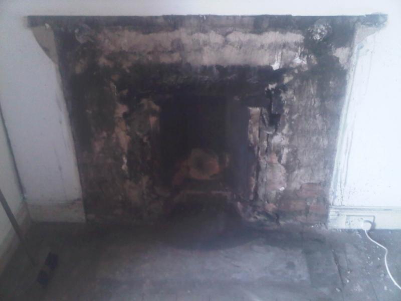

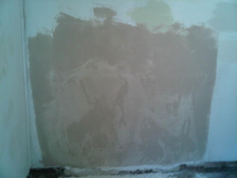

...but first disaster not far away. Wanted to use lime putty for patching, in keeping with lime plaster on walls, but I'd not worked with the stuff before nor patched anything this size.
Serves me right for not asking for help over on the plasterers forum. Removed it all to redo - improved result but not perfect (still some cracking). Tried to finish off with Finishing Stuff but run into a similar problem.
I think the problem with the putty was it wasn't 'knocked up' enough (it was ready mixed) or rubbed up enough with the float and maybe the wall wasn't damp enough (I'd built up the opening with bricks removed from the kitchen fireplace). Don't know what went wrong with the finishing stuff but took the cowboy route and finished off with joint cement.
Won't take much to knock some of it off but finish looks fine and that section will be behind a bed.

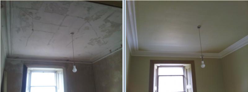

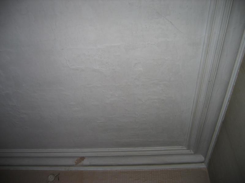

Ceiling surface wasn't sound...
...but nothing too serious. Scraped, washed, filled, painted.
There was a bit of work in sanding the floor to get it to one colour. Had to use the lowest grade to start with but lost a lot of sheets due to ripping on nails etc. Have since seen silicone carbide sheets online and may give them a try next time.

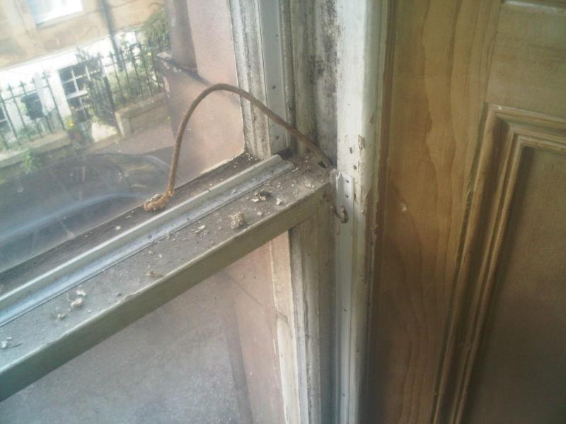

Still to renew hardware on window and draughtproof. Sockets to be fitted by sparky.
...wheres the airbrick in the fireplace?
One chimney sweep advised not to use a vent in case of leaking fumes from neighbouring gas appliances whilst a hetas registered sweep said to just block it up and that no vent was required - maybe I should check with building regs though. Won't take long to create a vent if needed.
