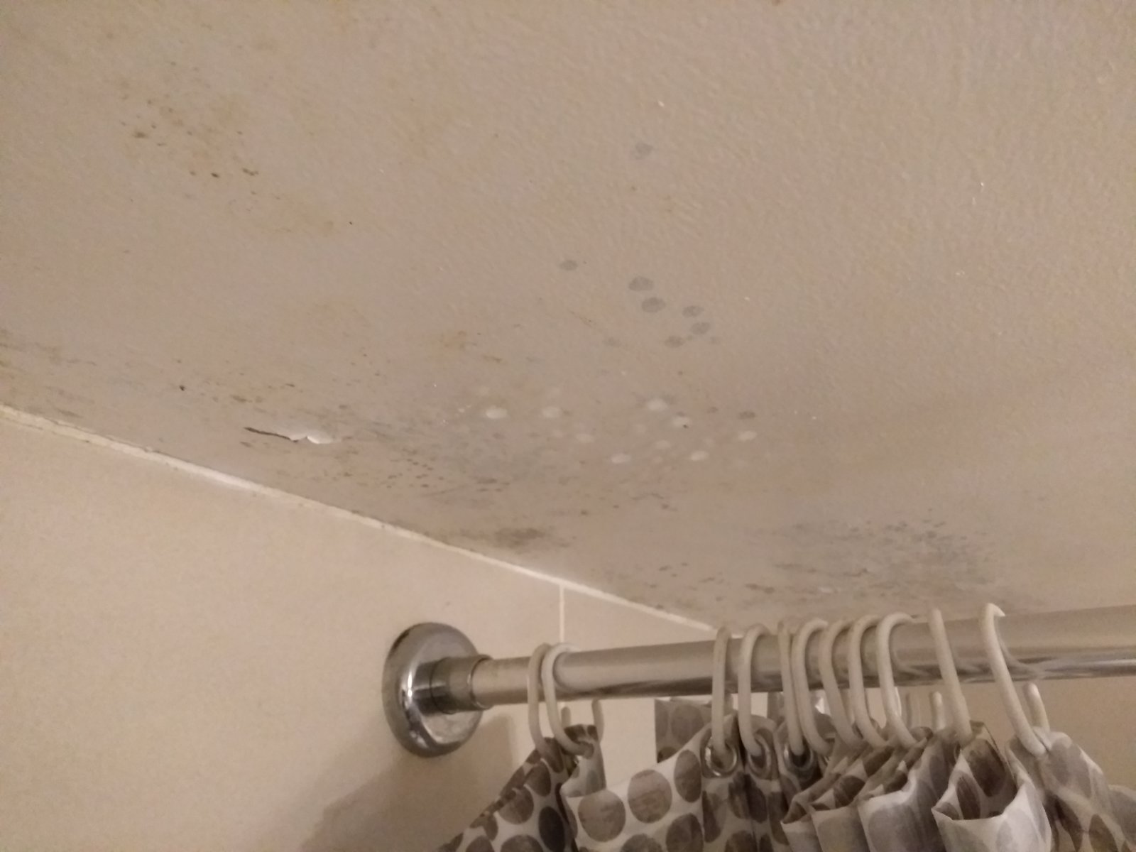

Hi, each Winter in particular the ceiling in our bathroom gets terribly wet, dripping, and yet we've not had this at other houses we've owned.
Several years ago we fitted an extractor to try to limit it, but per the attached photo, it's still very bad.
It's really only the ceiling above the window, and above the bath.
What do people suggest to combat this, please? We are forced to clean it up, and then repaint each year.
1960s brick built, cavity wall, insulated loft, vented pitched roof, double-glazed, radiators.
TIA

Show us your extractor fan.
It seems to be ineffective.
When do you turn it on, and how long does it run for after your shower?
Go into the loft and check if the loft insulation fully covers the bathroom ceiling, or if it has been disturbed. How thick is it?

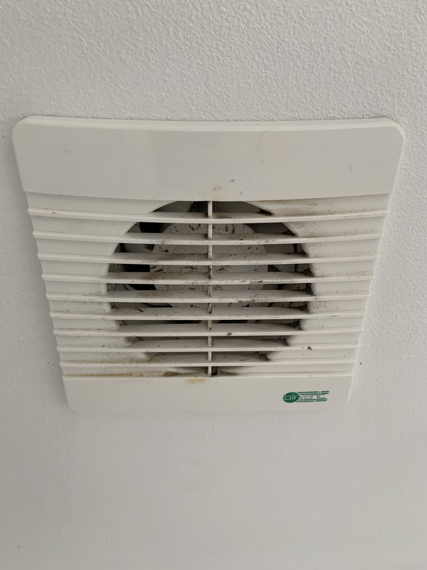

Hi John, thanks for taking time to reply. The extractor was wired to the bathroom light, so is on and off with the light. My wife does have the bath very hot, and tends to switch light off as she leaves room. The extractor sits just under a meter from the damp patch, they apparently couldn't fit it closer due to the narrow pitch on the roof above making access difficult. It extracts to a vent within the soffet, i'll check whether any vapour leaves it tonight at bath time. The electrician who fitted the extractor said he'd used a decent powerful brand, but then he also said he'd fit an isolator switch, which he didn't. This was 5-6 years ago. Thanks

it appears to be clogged with dust and fluff. Hoover and brush it clean. Have a look at the arrangement in the loft. You can probably fit a much more powerful one, assuming there is a bit of room above the ceiling and you have a 100mm duct. A typical builders fan has a throughput of about 60-80 cubic metres per hour, you can get one with 180 or 240 cu.m. The better ones have ball-bearing motors and are very quiet and economical in electricity use.
Try leaving the fan on longer, you should notice the window less steamy. If it is annoyingly noisy, that's another prompt to replace it.
You can have a new one wired with a run-on timer, up to half an hour, to dry the bathroom after use. This is quite easy if there is access to the wires in the ceiling rose, which from your description I expect there is.
Water vapour rises, so if the fan is in the ceiling, that will be OK.

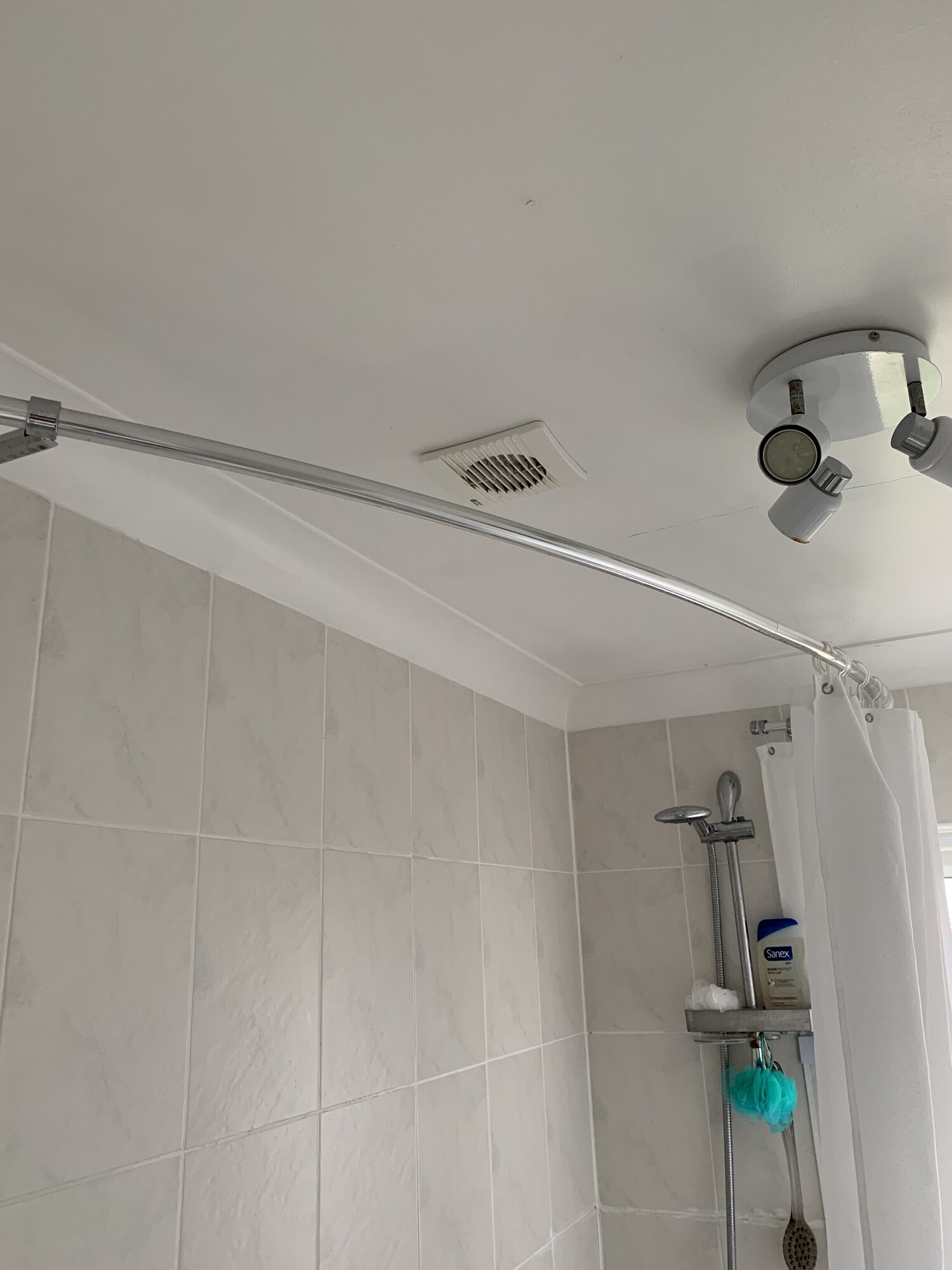

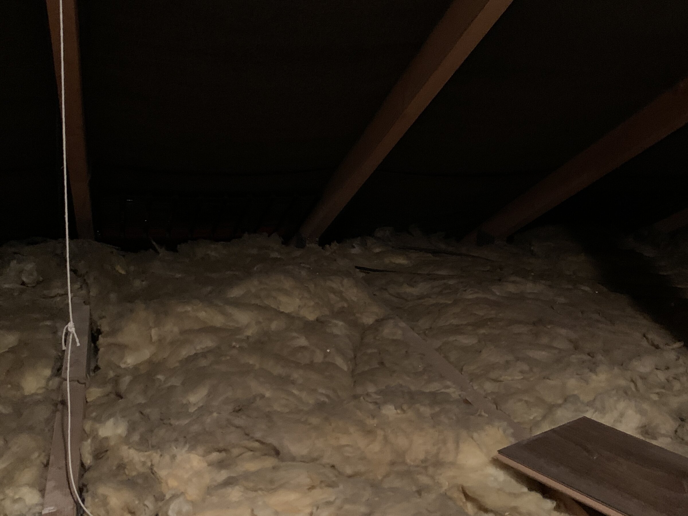

Hi All.
My first post on here - and I thought best to follow on from this one, as it seems to answer some of my questions.
So I seem to have a similar problem, in that my bathroom just does not get rid of moisture after we have a shower. We keep the window closed, as I thought if it were to be open in cold times like this, it would make matters worse?
Anyway, I've taken some photos to show the general setup in the bathroom --- but from what I've read, it might be to do with the power of the fan? or something else? Here are the photos taken:
The fan is this one: https://www.toolstation.com/airvent-100mm-low-profile-extractor-fan/p26862
Thanks in advance for any further ideas that might help newbie me!

Fan is feeble, change for in-line fan in loft, plenty of room for it.
This type of thing.
https://www.screwfix.com/p/xpelair-...VVYBQBh0jtQKYEAQYBSABEgJvvPD_BwE&gclsrc=aw.ds
