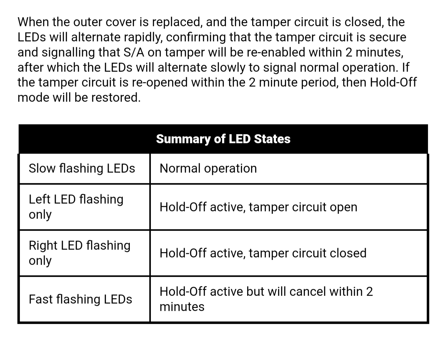

Hi all
I have a texecom premier elite 24 with the Odyssey 5e external sounder, installed about 3 years ago.
I've just noticed yesterday that the LED indicators on the sounder are no longer alternating left and right, it's now only got the left LED flashing slowly as if the hold off is active - but I've not done any work recently and certainly haven't flashed the strobe 3 times.
Looking on Wintex, I don't see any issues - but I'm no expert.
Anyone got any experience of maybe a failed LED in the external sounder?

Firing the bell should take it out of hold off.
As for LEDs I can never remember all the different states, also have to ask my self is it my right or the bells right.
maybe take and post a short video of it after dark.
From the manual, LED status attached, cheers

is the bell tamper open.
clearly only 1 led is flashing (not fast flashing), which suggests its in hold off mode and tamper open.
Remove the negative in the panel and see if it rings …..if that works then …..remove bell tamper return wire in panel and touch it on the bell ring terminal ….if it rings then I would say the led on the right has blown ….as they are on a fly lead it may have got some water in it and rotted away …

Anyhow, I've done as suggested and here's the findings:
Negative wire in panel removed - no ringing.
Tamper return touched on bell ring - it rings.
Bell cover removed without hold off - it rings.
Alarm triggered - it rings.
Hold off activated, bell cover removed - rusty/rotted wire on right hand LED found. One of the wires had already fell off and as soon as I touched the LED the second wire fell off.
Left hand LED looking corroded, so chose not to touch it.
Thanks for the help all, at least I now know the cause and we all know these LEDs can rot off - literally!
There were no signs of water entering the bell box and no rust anywhere else in there, we live in the hills and the box is located fairly close under the eaves/gutter (over sized gutter) which makes a nice shelter and protects from downpours, so I'm going to guess it just moisture in the air that caused it. Though there is a chance of a one-off watering session when some builders hosed the wall during a pointing job a few years ago.
Now to see if Texecom will provide spares, as i can't see them online - and will use a little Vaseline at the base of the LEDs for future protection.
