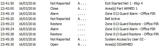

I'd appreciate some expert advice on the event log from my Texecom Elite 48
I have several dual mode wireless PIRs, and have just had the second spurious alarm since the new year - a different device each time. They are both in closed rooms with no obvious triggers so I naturally want to find what's going on.
As shown by the log last night, zone 13 alarmed. I was sitting right by the RKP when the alarm sounded and I was able to silence it within 10 seconds.
Am I right in understanding from the log that the PIR triggered twice during this period?
you part armed the system and 1hr 3mins 19 seconds first activation second later bell active, 3 seconds after it reset, and reactivated a second later and restored 4 seconds later 2 seconds after that you reset the alarm.

Given the closeness of the signals it would have still activated two signals with 7 seconds is the default for double knock, any less and they may never activate.
You can only do this with devices that are always awake (door contacts and shocks), hybrid mode (default value for DT's), automode wouldn't work at all as they sleep for a few minutes after an activation.
