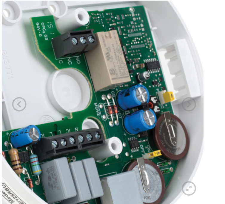

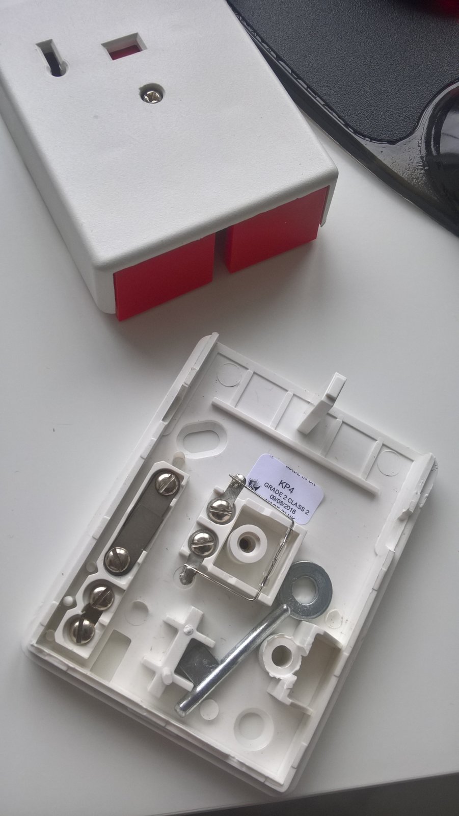

Hi,
do both of these wire into a regular zone on the panel? Does anyone have a wiring diagram for these please?
Any guidance will be appreciated. Thanks
Yes, smoke detector relay. I have the Aico Ei128RBU:
The PA is as follows:
I look forward to your guidance and thanks.

You can program a zone on your control panel as fire and make the zone normally closed in program zone.Connect wires on C and NC of smoke detector to zone on panel.
Panic button you and wire EOL or NC as smoke detector
do both of these not require power? Also, where do I connect the two wires on the PA?
Pa no power .... connect across the two screws that have the glass tube on (reed switch)
Smoke no power will take from whatever the smoke alarm is powered from ( 240v ac or battery )

ive connected several Honeywell alarms where ive only had PIR's to worry about. Just need some pointers with the texecom. So much more sophisticated! It's all in hand and thanks for the help pal
Update: The PA's are working a treat and will test the smokes relay tomorrow as don't want to wake the kids up!
