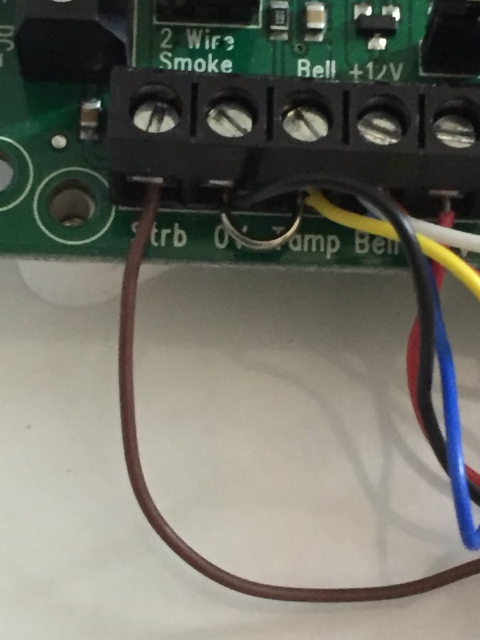

Do you mean a wire like between ov and t on bell connection?
This will need to be removed if the bell box is connected correctly.
If you are unsure that a zone is correct you and put a 2.2k resistor across the zone the outer connection or just make the zone not used in programming until you have sorted problem?
This way you can start to see if your are connecting items correctly
Sometimes it is easier if you post a photo of the thing that you are unsure of?

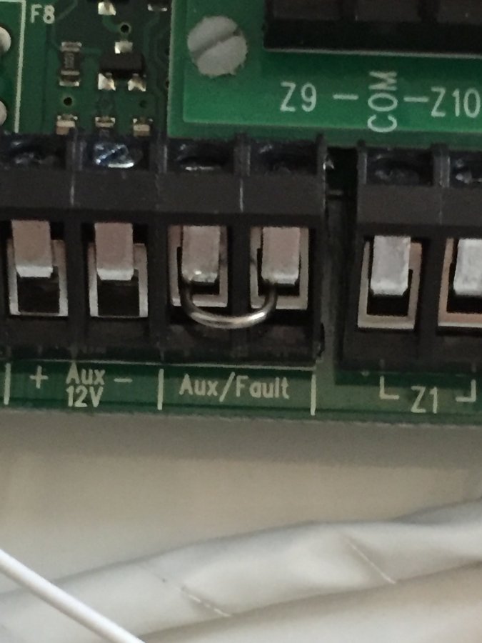

the links in the panel are to null out the tampers.
When the unit is fully wired, you can remove the links if the tamper/fault terminals are being used.
so you can remove the link between 0V and Tamper but not the Aux/fault
Leave the link in aux/tamper if not connecting anything to that.
Remove the wire link in bell connection ov to t when you are happy with bell box.
If you have tamper fault on bell box when you remove the wire link could be bell cover or wired wrong.

Do I take power from the AUX for the PIR's and if so do I then need to remove the link between AUX/Fault ?

Take power for pir to panel and connect into aux 12 volts NOT aux/tamper.
If you have used red and black for the power in the pir s twist all the reds together and the blacks twist together and put the red on + aux volts and the black in - aux volts

I have connected the internal sounders to Spk- and the + to the bell connection

Only problem is bell is constantly going off when the power is on. I have disconnected the bell and internal sounders and it is still going off?? That does not make sense to me. I have not enabled the bells own battery yet?
Any ideas as I need the power on to access the Com IP and it will not work without power.
the bell goes off if no power to for 15 minutes.(hmm battery not connected).
so sounds like the bell isn't wired properly/ setup properly or programed properly.
so whats connected in bell box, whats connected at the panels bell terminals?
I have connected the bell as per the Texecom instructions. That and the keypad are easy as there is only one way to connect them.
After it started going off I removed all of the bell and internal sounder boxes connections so I don't know why it is going off. There is a jumper in the bell box to enable it's internal battery. I have not enabled it yet.
