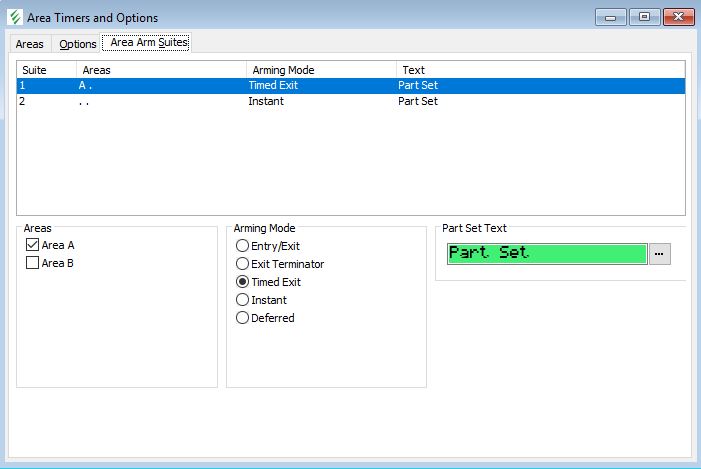

This is how the arm suite is setup.

If I deselect B from the area programming, when I part set, the landing PIR doesn't get omitted even though its ticked to do so.

area arm suites are to arm an area or group of areas not to part set the system
So to make it simple:-
1. remove area arm suites
2.program everything to area A
3. program omit 1 on the zones you want omitting during the part set.
when you full arm everything gets set.
when you part arm everything will be armed except the omitted 1 zones
To achieve a quicker arming method, wrt key presses, enable Quick arm on the keypads
press area system full sets
press part, press yes (evening arm, this is part set 1).
so part 1 omit doesn't work in an area arm suite.
to do it as area arm suites, you are full setting areas.
so all zones in Area A that you want arming in part set
all zones you don't want to arm in area B for the part set.
full arm is areas AB and part set would be Area A
arm suite 1 AB (full arm), arms suite 2 A (full arm A, part set system ie area b remains unset).
I would suggest you don't try this method as it can be complicated to know whats going on.
The panels event log helped identify the programming problem.
ie trying to part set a system using area arm suits, seen lots of engineers do this.
If the part set function doesn't work quite how you would like, write down how you would like it to work step by step.
