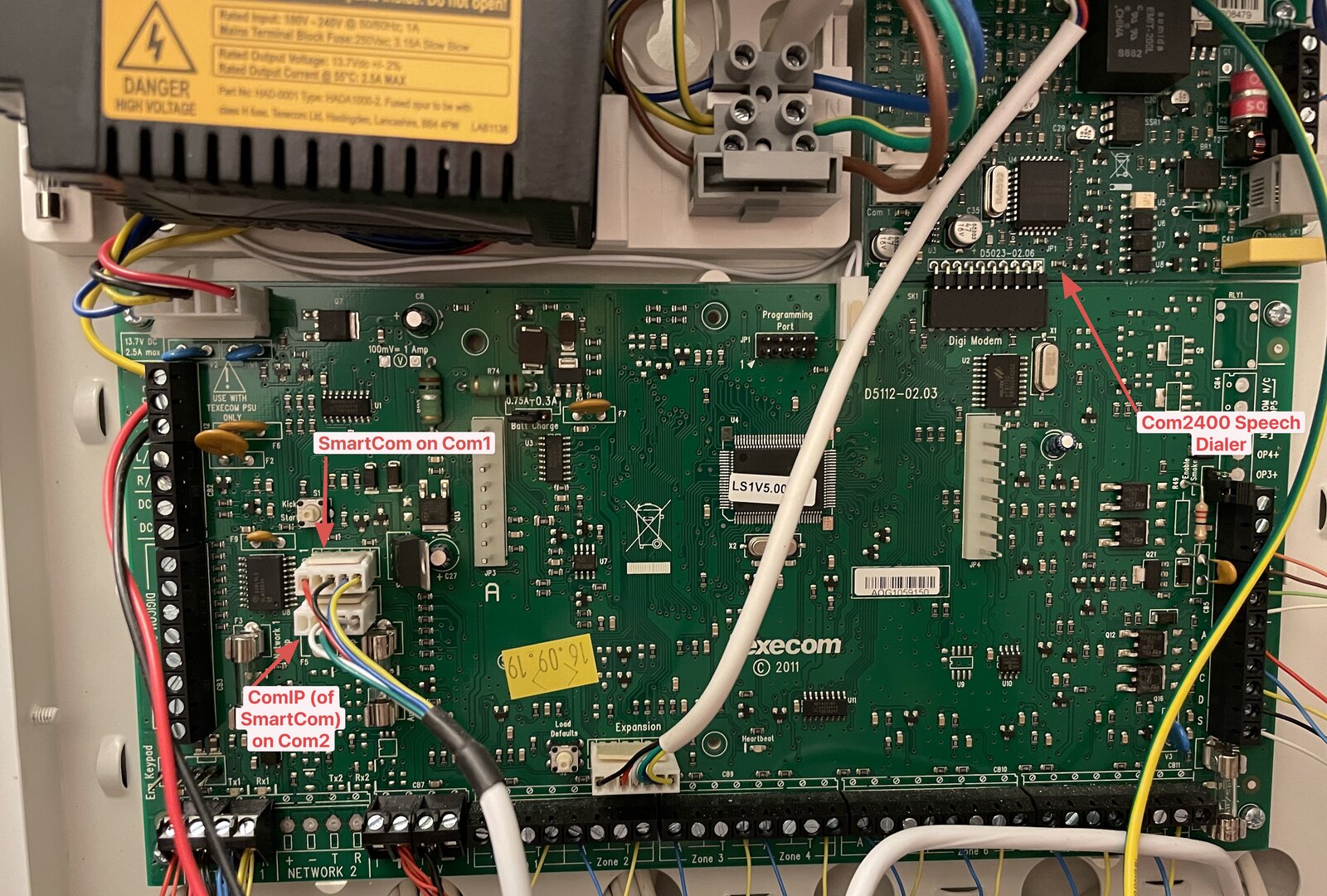

I need some assistance with setting up my Texecom Premier Elite 48 and SmartCom so that I can use it in HomeKit via Homebridge.

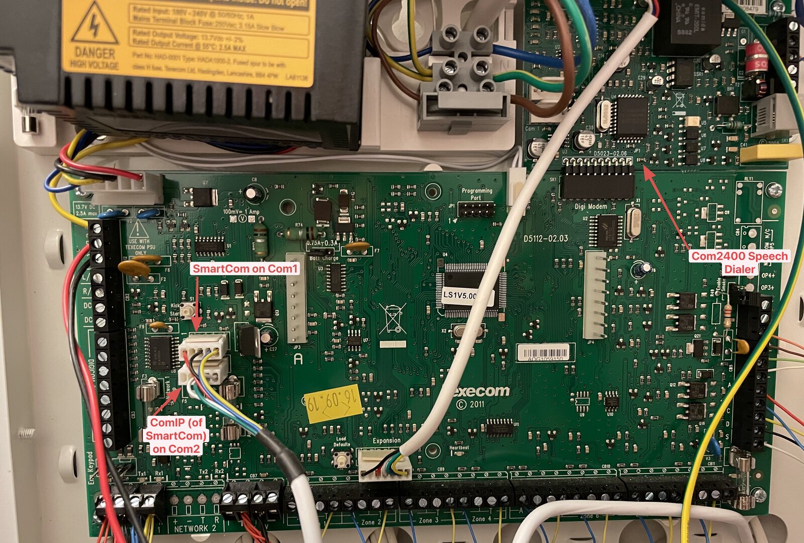

I have attached a picture of my board in case that helps. Sorry for the long post but I thought I would try to give as much info as possible.

Technically. you need a free comport.
The only panel would be 640 I suspect with 3 comports and a digimodem

So I would keep my SmartCom on Com1 and Com2, use the Gjd710 (not sure where this would connect) and then connect another ComIP to Com3 (using the adapter to where my current Com2400 is located)?
If I do what I did earlier and change the settings on Com2 to Crestron and set baud rate to 19200, what part of my existing setup will stop working?
Your installer should be able to do this.
All depends on what comport the ARC is using for Texecom connect.
Smart com
Comip from smart com
Comip home automation
Com1,2,3 but gjd would use Digi outputs

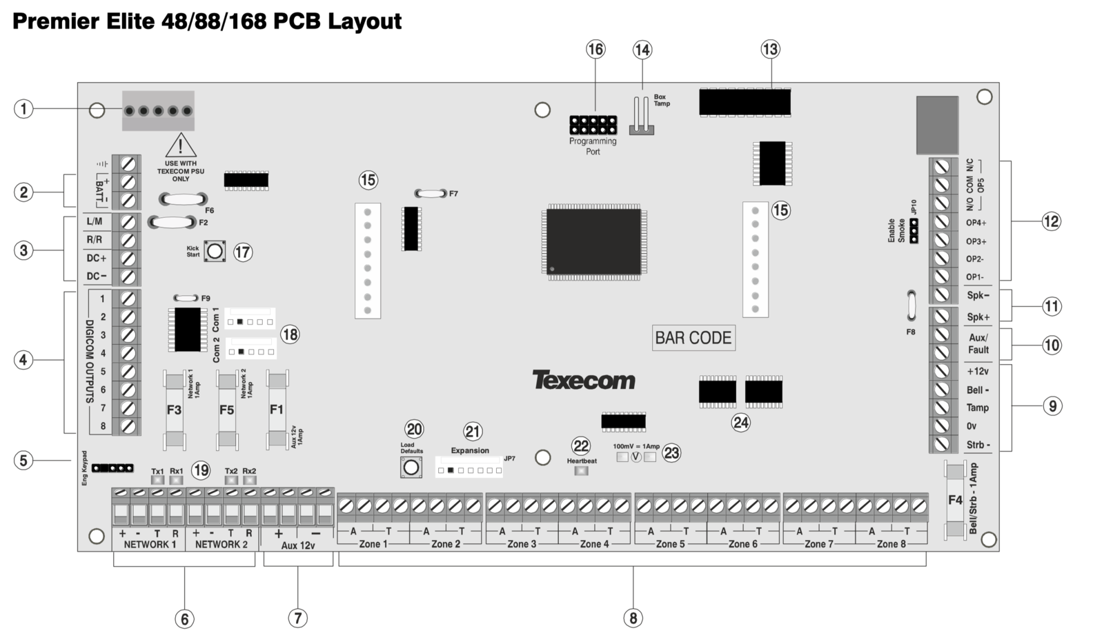

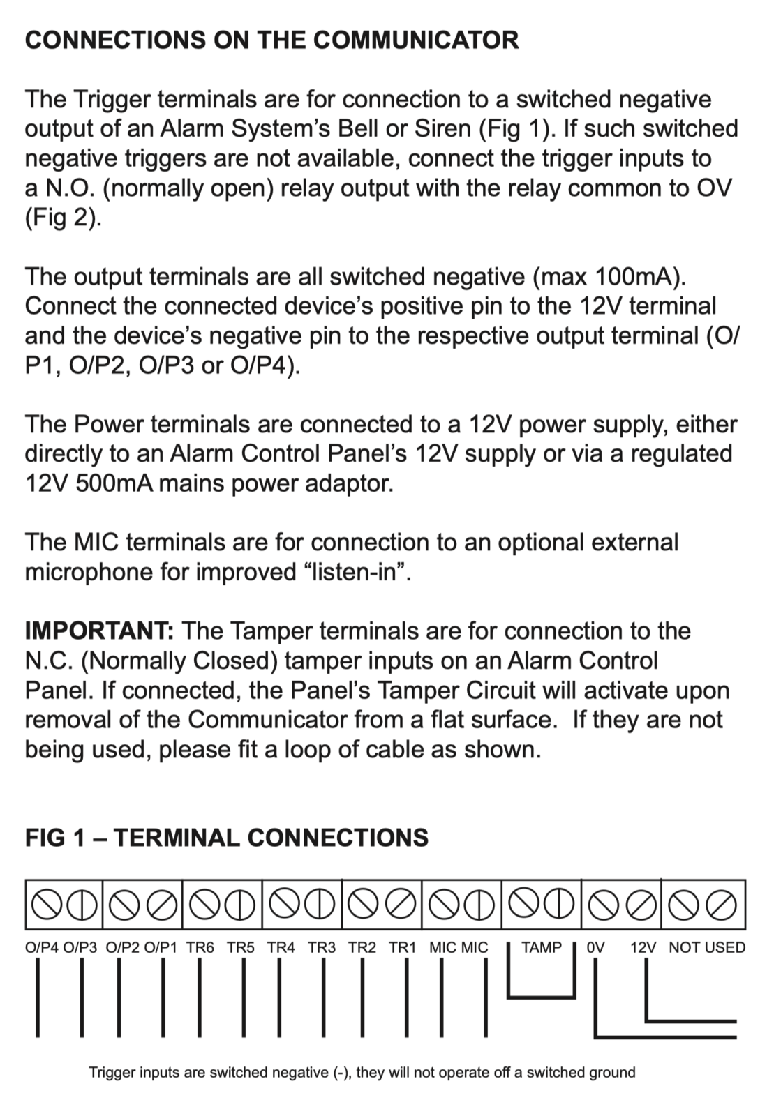

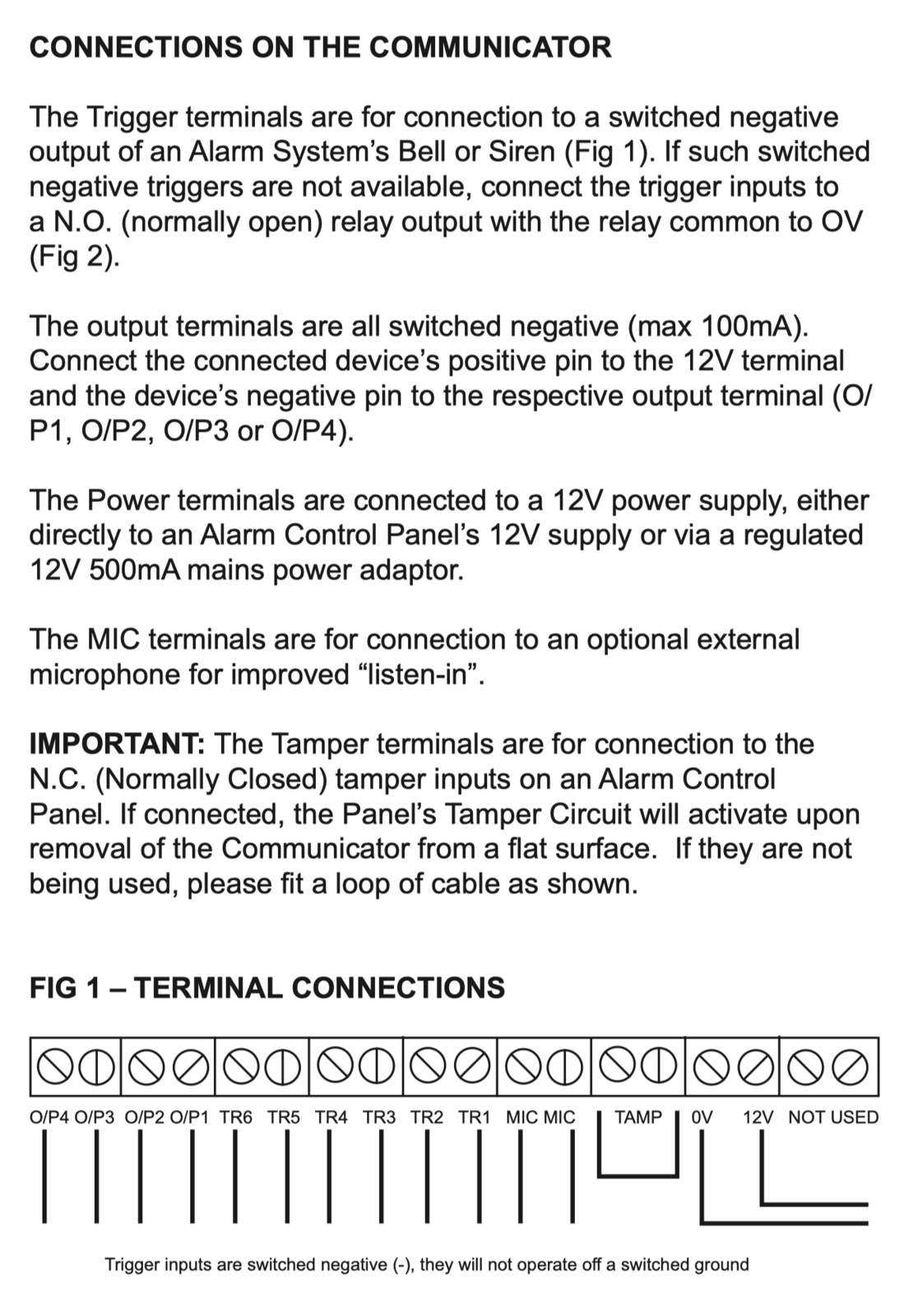

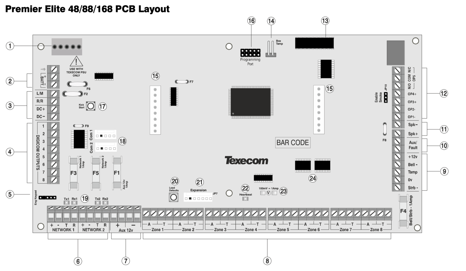

Would you be able to help me with the wiring of the GJD710. I have attached the layout for both the panel and dialler below.
Do I connect power (0v and 12v) to the section 7 on the panel (Aux 12v)?
I am not sure out to wire the O/P and TR terminals on the dialler. I assume these connect to the Digicom Outputs (section 4) of the panel?
I am also not sure if I need to do anything with the Tamper terminals on the dialler.
If you could give me clear instructions that would greatly appreciated.
WRT power you can take it from anywhere as long as you don't exceed power available and blow the fuse.
If you are struggling for power you can place an inline 1A fuse on the DC+ on the digi outputs and take the power from there(this is fused so you need to add the 1A in line fuse if going down that route).
Digi outputs are what ever you program them up as.
The tamper is up to you but I always wire it into a spare zone on the panel.
