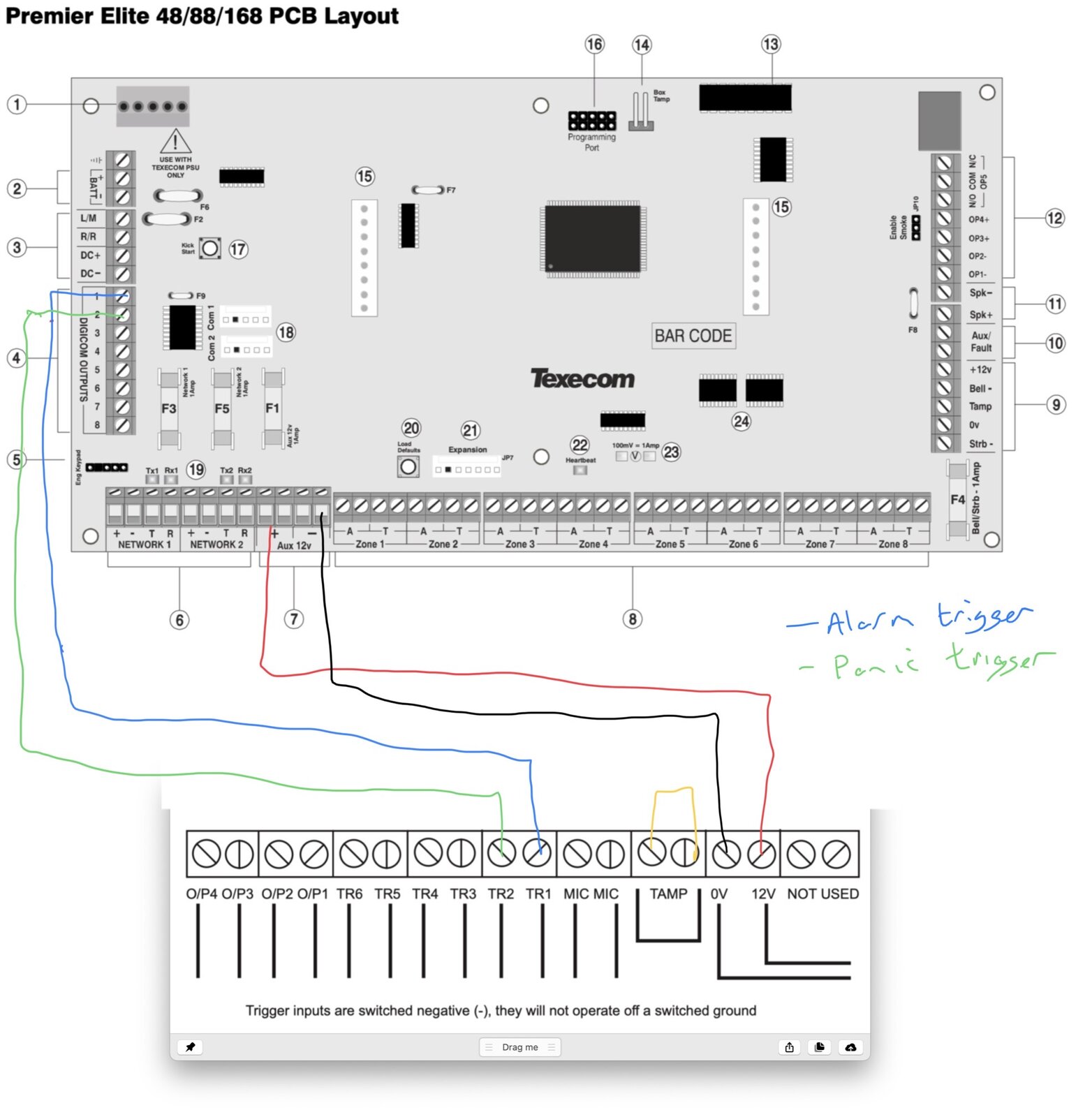

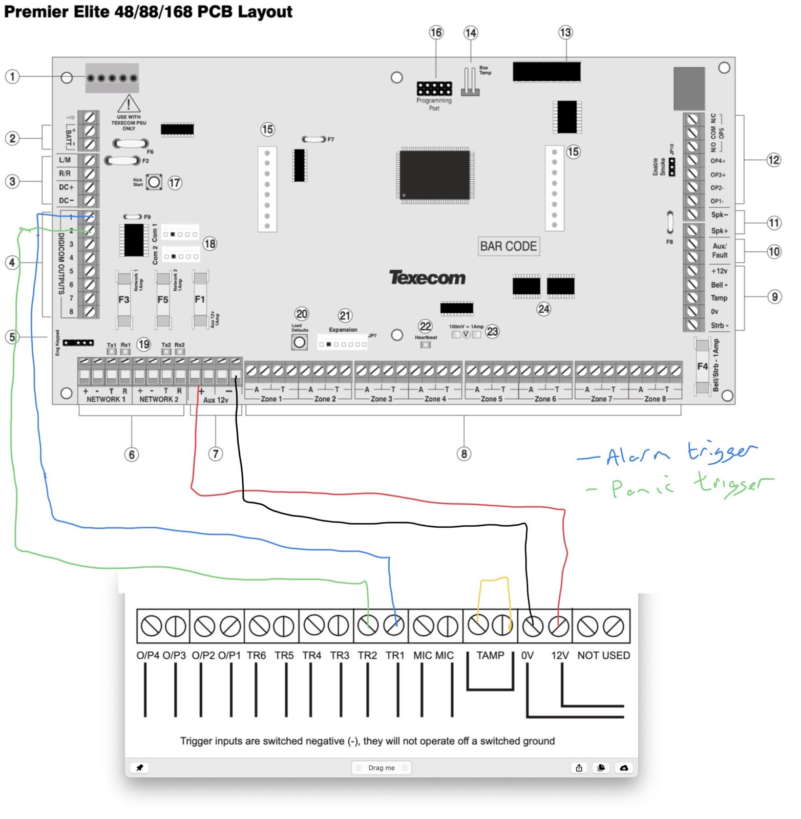

I am still totally confused about the wiring for the dialler. I have two types of output used at the moment. Output 2 for Panic and Output 3 for Alarm.
is there any chance you could help me match section and terminal numbers from the diagrams of the panel and dialler above?
I don’t have any spare zones in the panel so not sure if what to do with the taper either
What condition do you want to monitor?
I cant tell which output to wire to where, because I don't know on what conditions you wish to monitor or how each output is programmed.
However.
Digi output 1 to trigger 1 keeps things simple, then your messages need to match what the output/trigger is programmed for.
If you don't have a spare zone for the tamper, but your not using the aux tamper/fault you could wire it into there instead. Other than that the instructions for the dialler tell you what to do if your not using the units tamper might be worth a read and getting back if you still don't understand.
Unfortunately I do not know what your outputs are programmed up as, it could be the default values or it could be something completely different. You or your installer could haver changed them.

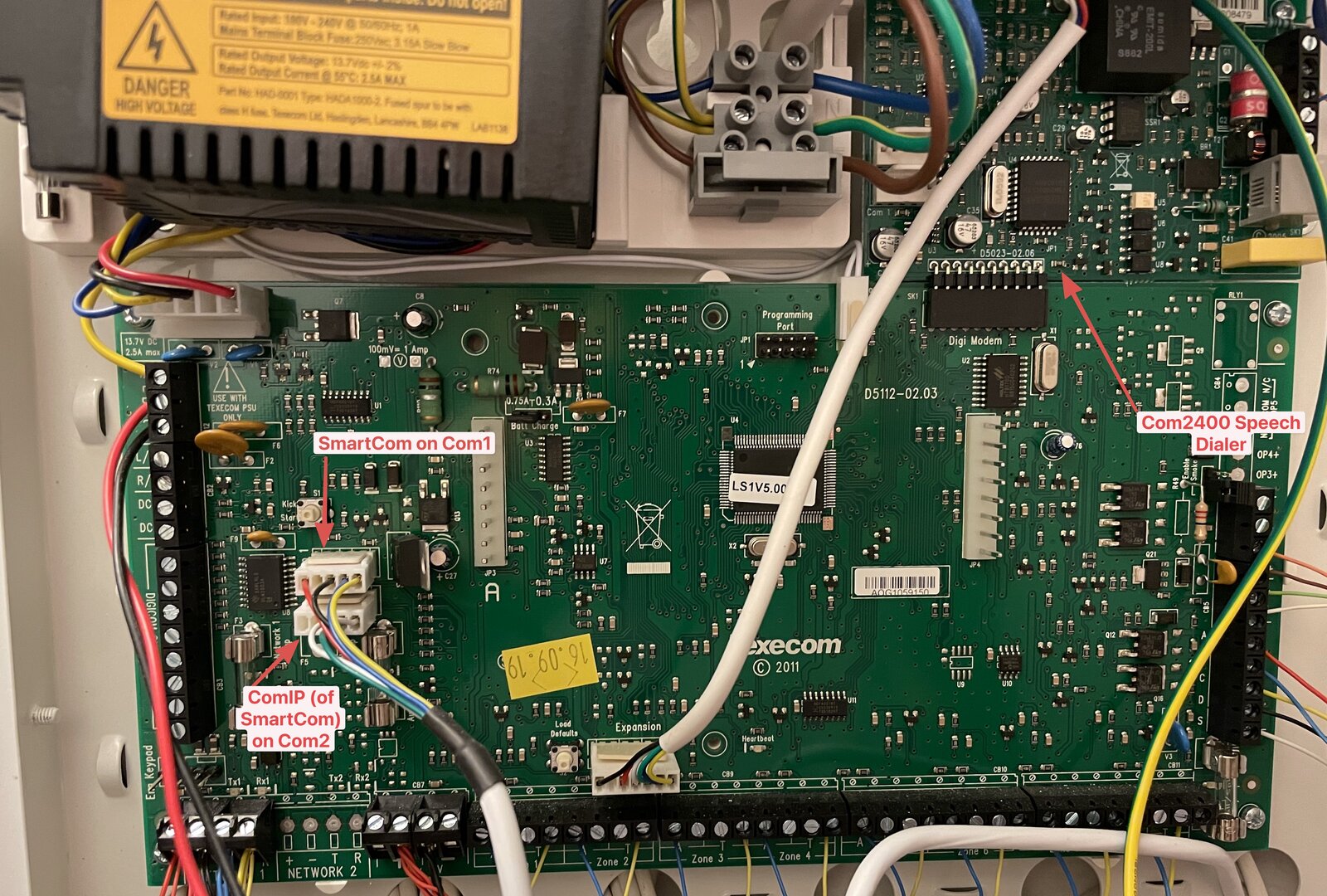

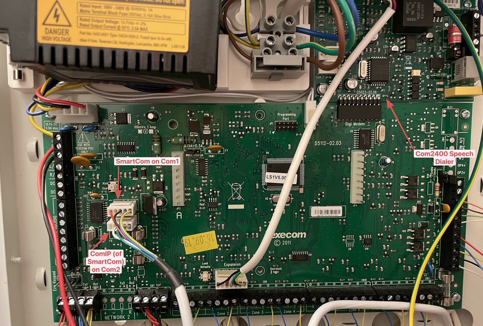

Will the wiring in the first picture work for me or am I missing something. I have reattached a picture of my actual board to show which terminals are already occupied and which are free. Any help you can provide would be greatly appreciated
    CleanShot 2022-02-24 at [email protected]
