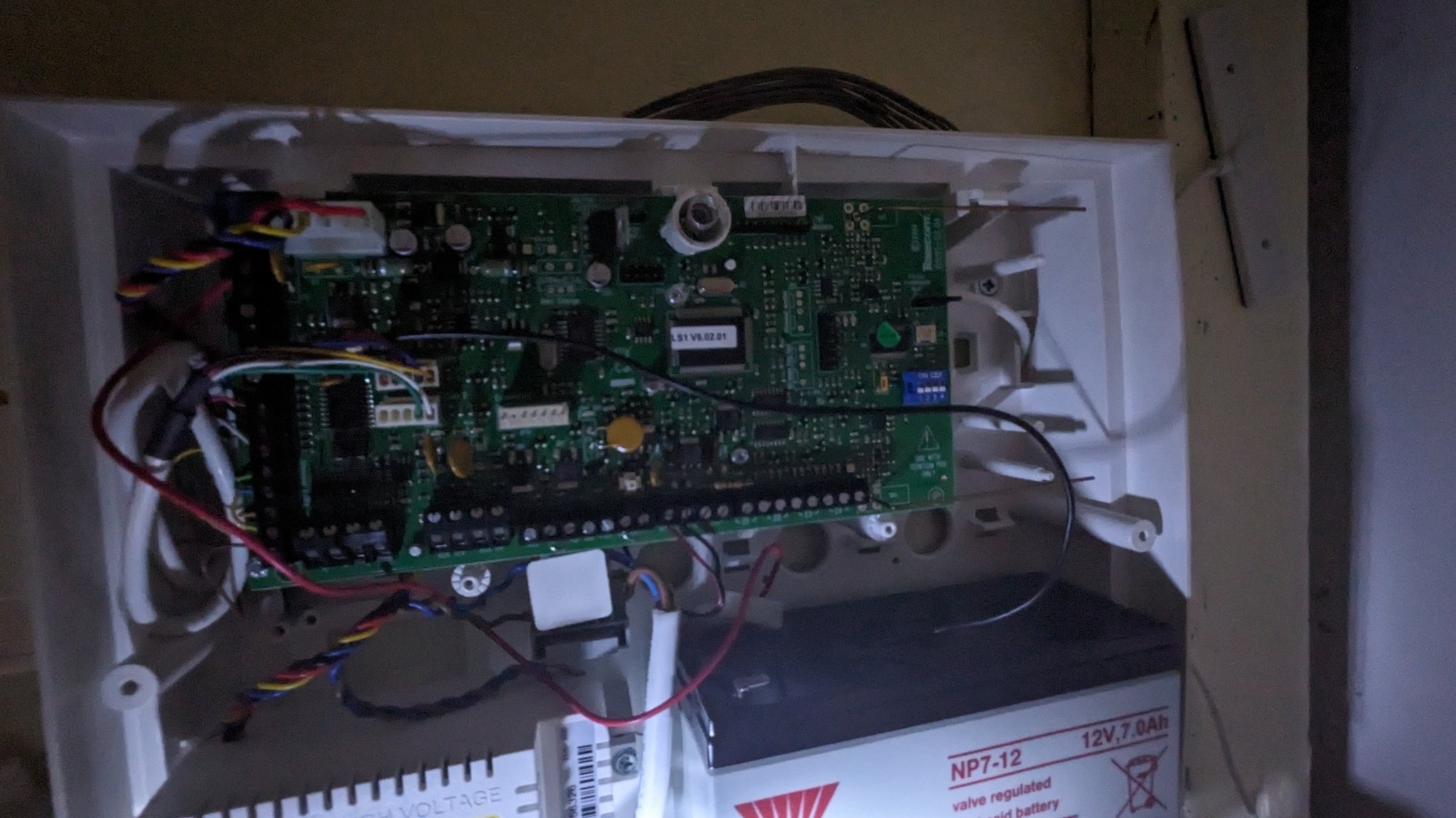

Hi fully working system up until now. I moved my wireless keypad to opposite end of the property and the keypad was still working. I was making some settings adding another device and learning, then the screen froze. So thought it would be a good idea to remove the batteries now I get richochet network not found . I have disconnected the battery so it doesnt run down.
Do i need this cable, here or should I try to see if it works with the keypad near the panel ?

Not sure what you have done and why you think you need a cable, I see you have a smart com attached?
you have the engineers code and a smart com so you can use wintex and ricochet monitor to look at the keypad, the keypad will be blue if its not powered up and still on the system

If you know the engineers code, the chances are you don't know the UDL Passcode.
If your panel is on the original installers account and upgraded to 6.04 or higher then you wont be able to use the smartcom to connect to the panel, you would need a usbcom cable or connect via ip address using the local ip address of the panel.
The problem with that is the comip unit could be sending messages out and that could make a connection potentially difficult until you disable the reporting side.

Would have to work through these as we currently dont have a functioning keypad, but you dont have the lead to learn the keypad on, so how did you initially learn the keypad on?
Also cant make out if the panels commissioning jumper is on or off position.

Commissioning jumper is off. I failed to add (sorry) that the smart com was added by another security firm when they took over the maintenance. I believe this was to enable the external monitoring centre (which i have).
I ring them up prior to tell them i am troubleshooting as the alarm goes off of course when trying to enable the keypad
if it’s being monitored by an ARC you should get the company maintaining the system to maintain it.
as things have to be done a certain way depending on the monitoring you have.
However if it’s just the Texecom app notifications it becomes less of an issue but the company maintaining it are likely to be less than happy your fiddling with it.
