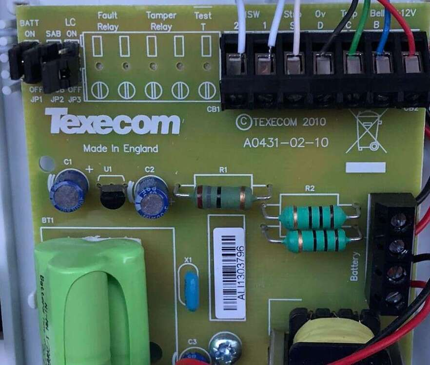

Really strange one... it's been a while since I installed a Texecom unit (and that was Veritas) but I've just installed a new Premier Elite 24 (wired) panel.
All zones are working, and I can set the system, but when the system alarms (when I fail to enter the user code on entry) but external bell siren does not sound. The strobe on the bell box does however, as does the internal keypad sounder of course.
When I test the Bell from the Engineer Utils on the keypad, both the bell and the strobe work respectively. When you remove the lid, the bell siren also sounds as it should for tamper.
What could cause the bell siren to not activate when the system goes in to alarm? All wiring must be correct if the Bell test works surely? As its a brand new install, there isn't some default setting I need to set to enable the bell siren is there? (can't imagine why)

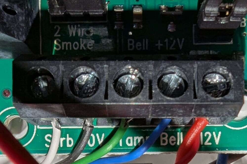

Bell wiring:
Panel wiring:

Most common reason for the bell not to sound after entry sounded and keypad is sounding is the second entry time.
Set that to zero and the bell should sound when first entry time expires.
Area options/ Area timers second Entry Time
