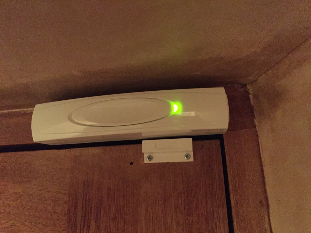

I have a Texecom Richochet 32W Panel which is linked up to various PIRs and Door Contacts. I've recently had a new door installed which meant that I had to remove the door contact. I've re-installed on the new door, however, it no longer works. The unit in question is a GBC-0001 and is continuously flashing green. The panel box says System Error and points to a tamper issue.
I have been unable to reset the error and I can't set the alarm at the moment because it's the main entry point and I'm not able to omit.

Ok, so I've just swapped the back plate with one which I know is working. The other is still working and the back door still has an error. The unit is fit together correctly and I hear the click when I screw it in. When I took it off, the light remained red constant but when I put it back together it is flashing green.
Have attached a photo so you can see how it's been installed.

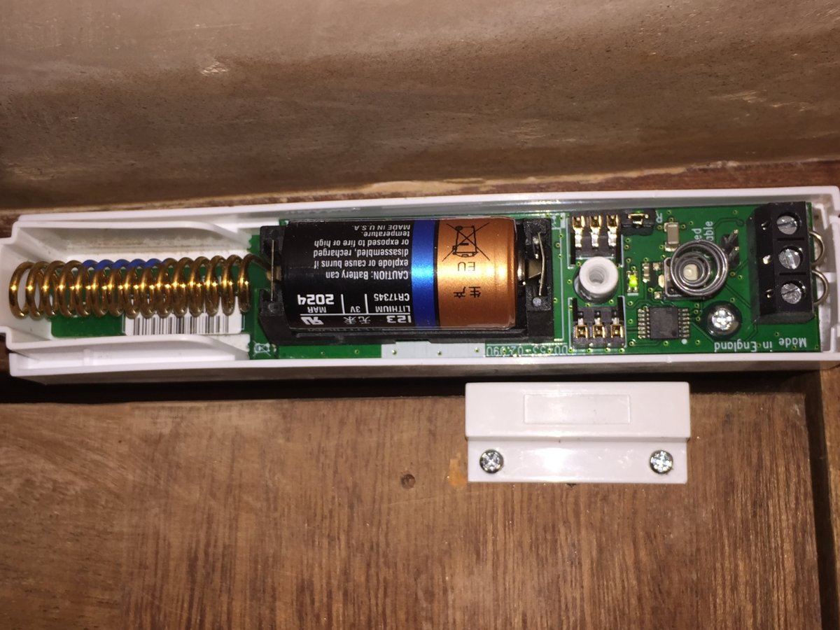

The white marking near the battery is the alarm reed,magnet should be line with white marks.
You could hold micro switch in with your finger and get someone else to reset alarm and see if tamper clears
The learn link is still on learn pins as well,that's only to learn device onto system

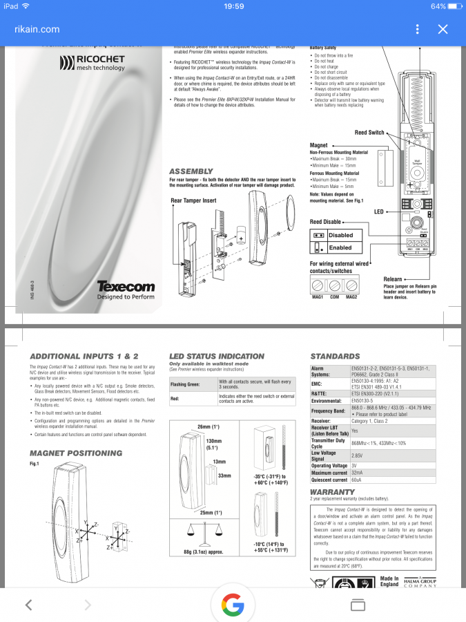

The door contact needs to be seated correctly, it also needs the relearn pins and disable reed pins to be unshorted, it also requires the two metal links to be left in the terminals at the bottom unless you are wiring in a detector to that device.
manually holding the tampers in without the magnet near by should give you active ststus, but you would need to clear the fault with the tampers held in.

The black jumper is on the learn pins in contact.
That jumper wants removing,just leave jumper on one pin so you can use at a later date to re learn.

Sorry for the belated reply guys, I managed to get the door contact working today after re-positioning the magnet then deleting and re-learning the device.
