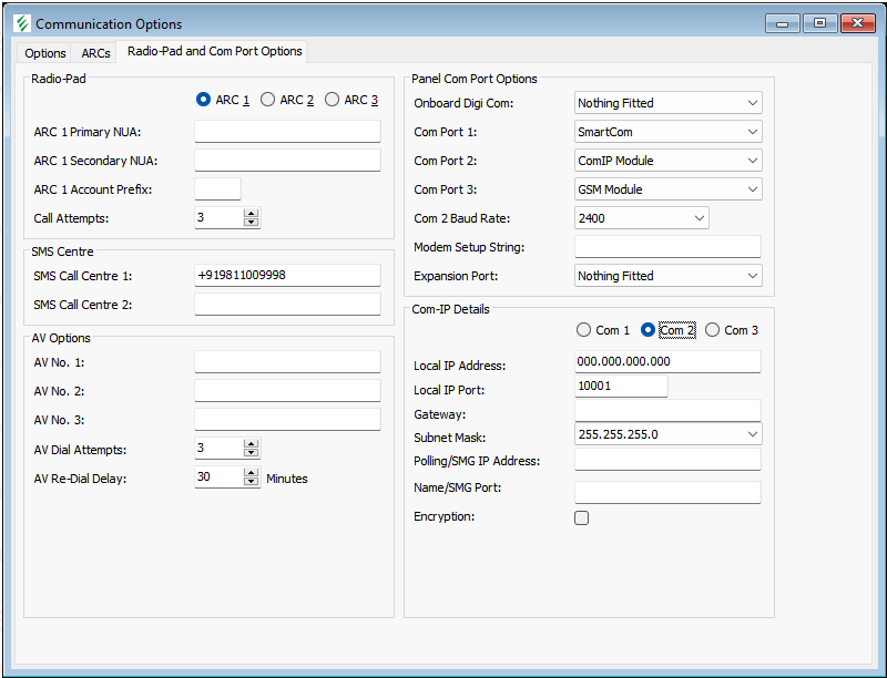

how is it’ll connected and programmed in the panel?
Its connected via the Com Port 1 - Smartcom and Com Port 2 - ComIP.
DHCP is being used to assign the IP address.
UDL is set and verified.

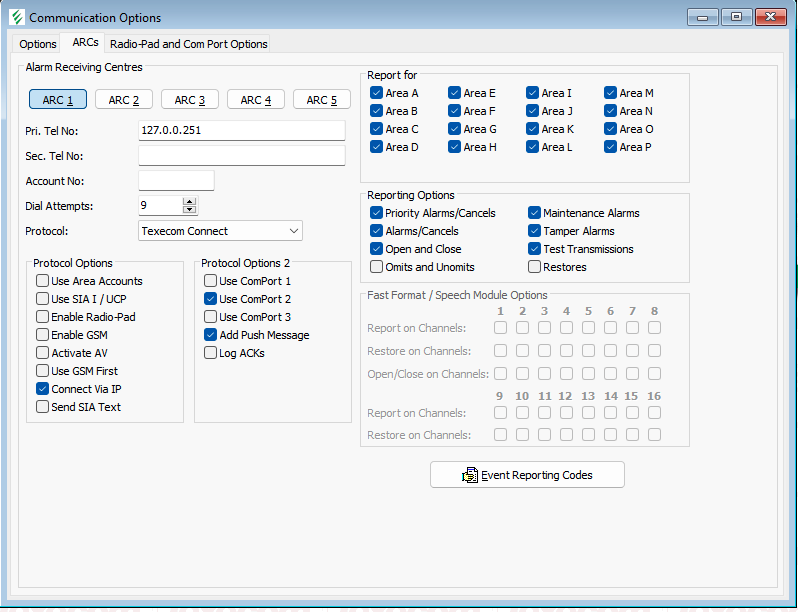

ARC1 has texecom connect defined.
Com ports are set on Com1 - Smartcom and Com2- ComIP

Do you have a picture of com1 and com 2 connections?

Texecom india checked my programming by taking my system on remote and checking my panel via Wintex.
They also asked me to ship the smartcom to them which they confirmed that they connected to a different panel at their end and the cloud led stabilised and they were be able to connect via Texecom Cloud and Connect.
I'll upload a picture of my com port's tomorrow morning. The configuration I can upload right now
