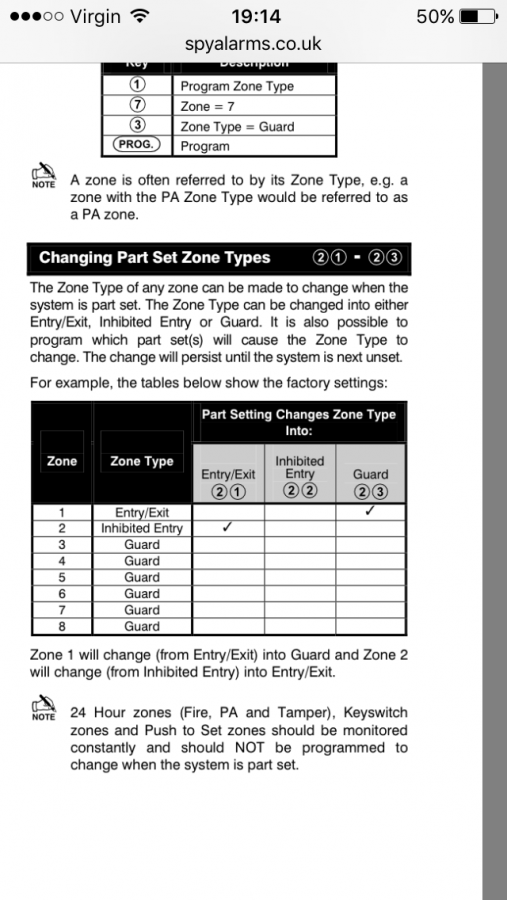

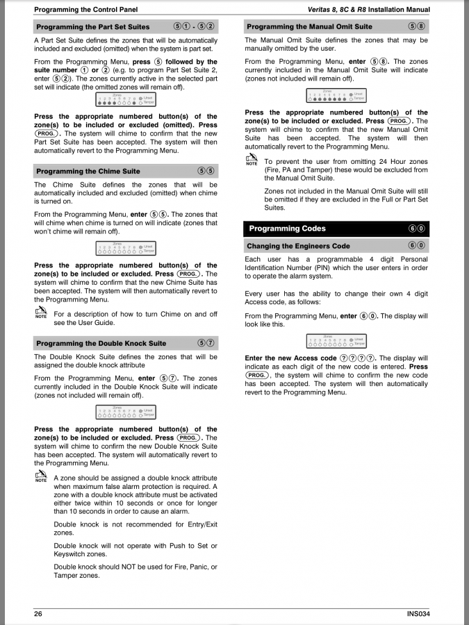

try this
You need to set up part set suite for each part set
Option 51
This will show you what zone are on in part set
So zone 3 and 4 led need to be off in the part suite and all other zones need to be lit(red)
Now when you part set zones 3 and 4 will be off.
Neil a option will only change zone function not set up part set function
To set up a part set suite you will need the engineer code to do this
Hope this helps

Thanks mate it worked, just another question please, is there any reason entry/exit is hit & miss? It don't always activate when the door is opened, possibly 1 in every 5 tries does the entry /exit start timing down.
Are 100% sure door contacts are on entry/exit and not a movement sensor?
A door contact will start entry timer when door opened
A movement sensor will start entry time when first picks up movememt as long as it is programmed for entry/exit
Hope that explains
