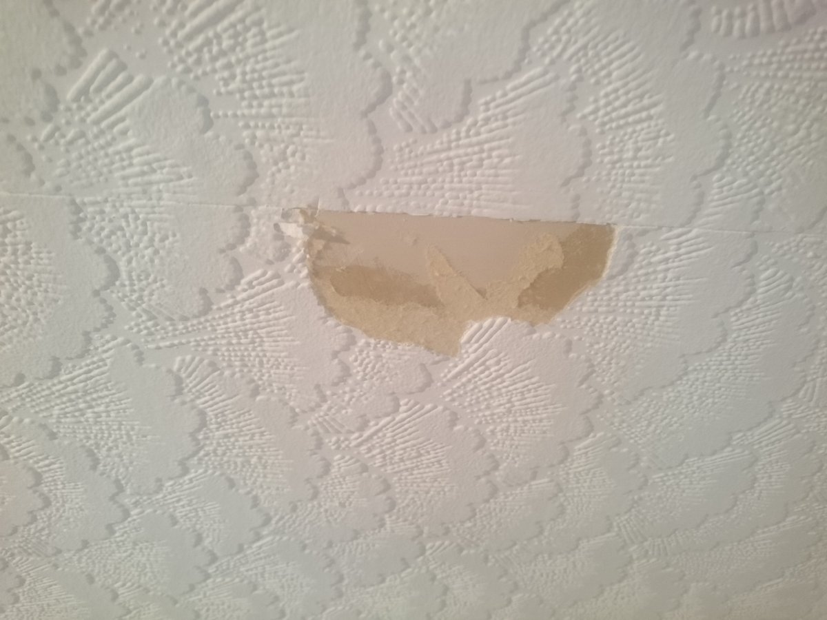

The "Boss" would like the texture ceiling in our living room removed - and for once I agree with her.
It appears to be a textured paper stuck onto plasterboard.
I have done some investigating, and it appears that the ceiling has already been boarded over twice - on top of a lathe and plaster ceiling. Therefore re-boarding is not an option unless the whole lot comes down and we start again. As you can imagine, I am very keen to avoid this.
The ceiling actually seems in fairly good condition when I peel off a small area of paper (see pic).
I am therefore considering what options are available.
I think peeling the paper off is essential (unless someone has a plan where I don't need to), however after that what options are available to me? Is getting a plaster skim on it the only option (there is already coving around the ceiling which is in good nick - would this need to be removed for skimming?). I did think about something like the polycell paint to get a strong undercoat and then just paint it. Too much of a bodge?
Any input appreciated. Thanks in advance

that stuff looks like it might be a blown vinyl, in which case it should be easy-peel (starting at a corner) and leave a thin lining paper behind, which if necessary you can wet with a garden sprayer and scrape off.
These thick textured coatings are likely to have been used to conceal a bad ceiling though. You will have to assess what appears.

I have started peeling more off, and I wouldn't describe it as easy peel. Lots of work with a scraper and water spray.
Underneath seems to be solid platerboard - although its very smooth (if that makes sense) - almost shiny.
I have not found any joints yet under the paper, so am now wondering if its actually a plastered ceiling which has been papered.
Will keep scraping until I have something more to show, and then would be really glad of further comment.

Its blown vinyl, dry strip it, wet the back with hot soapy water and it will fly off after it has soaked for 5 minutes or so.
