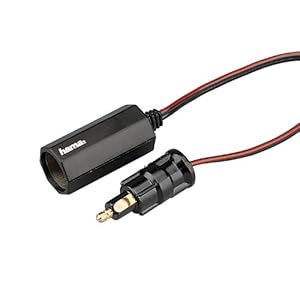

also the coaxial sockets both for cigarette lighters and the smaller one done by Hella
but even with these there is no difference between 12v and 24v. I have seen what happens when some one thinks there is a dropper fitted and they will get 12v but in fact get 24v.
It seems odd that 12v MUST be written on the socket but not the plug. 721.55.2.2
