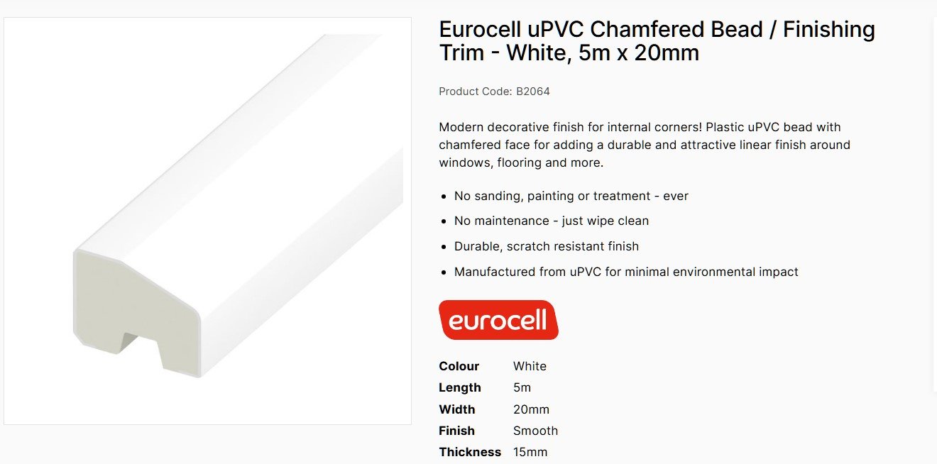

Hi,
I am looking to replace a worktop in a kitchen. There will be a sink in the worktop. Washing machine and dishwasher underneath so a little bit of heat. No cooker or oven involved they are on a different wall.
The existing worktop is 61cm deep. I have found a suitable worktop but it is only 60cm deep. Due to a reason too hard to explain I need to fit the new worktop with the front at the same distance from the wall as the old worktop, which will leave a gap at the back of the worktop of 1cm between the wall and the worktop. I can pack it out a bit to keep the worktop rigid. But I still have the problem of having to seal up the area between the wall and the worktop to prevent spillage.
My question is: would it be a big mistake to use the following product fixed in place with silicon or acrylic adhesive?
Thank you all.

Not so easy to find a matching worktop at the right price. Plus it is a long cut to do without proper tools. I will be buying a jigsaw and downcut blades to do the sink cut-out.
I have to put something between the wall and the worktop anyway. I can also get quarter round quadrant 17mm deep which would probably do the job. What normally goes there? The quadrant is meant to be for that kind of thing, isn't it?
Not actually made for that use, no, it is intended for UPVC door/window fitters, but yes, it works just as well indoors. It's not self-adhesive, and so needs something suitable, to stick it in place - and will solve your problem for not much cost.
Add a matching upstand usually around 12mm - 18mmthick .
Too expensive. Plus there are tiles on the wall with pictures of bowls of fruit which would be cut in half because the upstand goes higher up the wall.

Howdens do a 616mm worktop which you can cut 6mm off with a downcut blade, granted it'll take ages, but its better than a 10mm gap.
Can you fit the worktop, then put a sheet of plasterboard on the wall above it ?
If not, a competent tiler would get most half decent tiles ( not chamfered) to bridge a 1cm gap, including a silicone bead along the join to worktop. (Usually done by bridging the gap with the cardboard off the tile boxes, to ‘sit’ a (8mm ) tile on, + 2or 3 mm adhesive ). :-)
