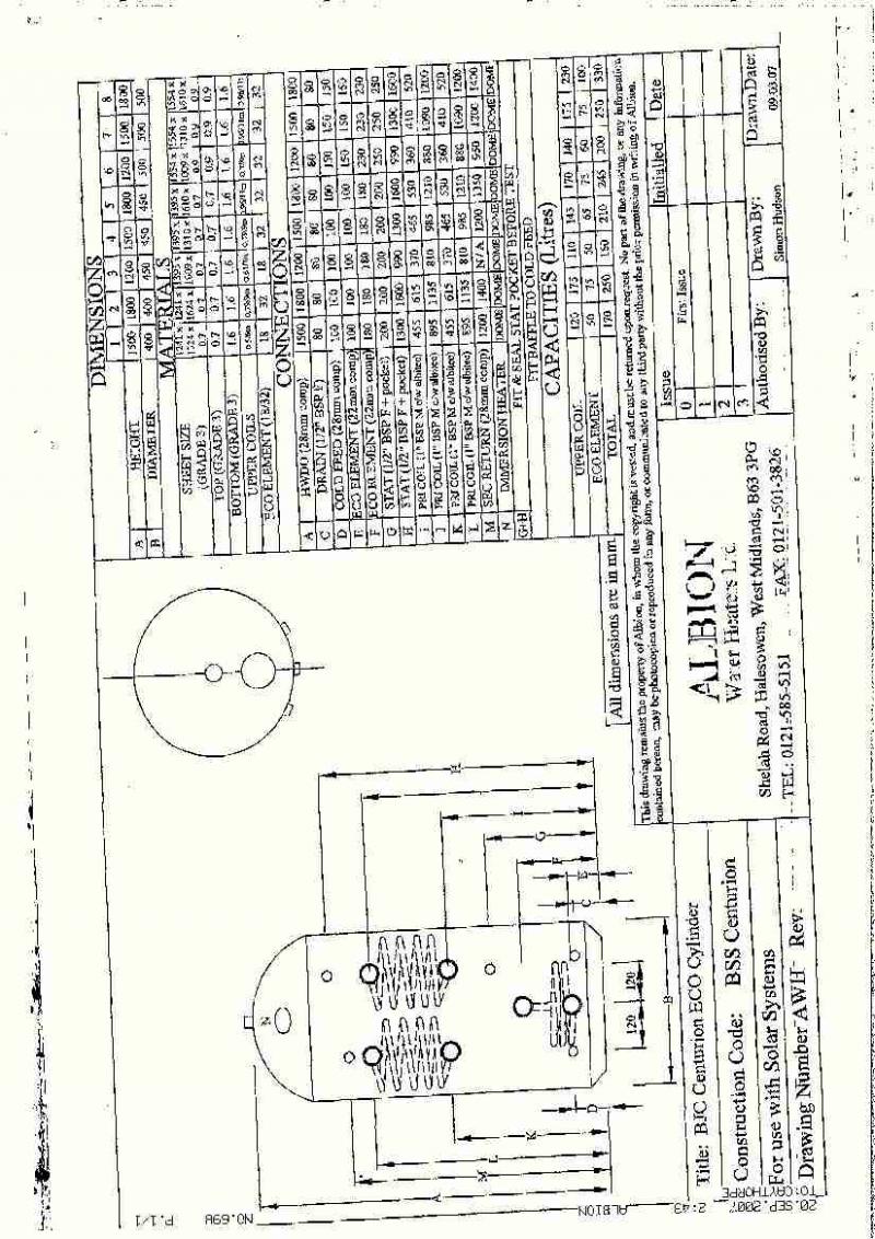

No injector tee. There is a high limit stat on the gravity. Vent is on the primary as shown in the drawing. No vent on gravity.
Picasso - Albion Centurion cylinder. coils are small bore than the 1" which is feeding them.

The gravity circuit should rise directly from the boiler to an open vent. Its possible that the alternate boiler tapping being used for the vent is adequate.
This is so that if too much heat is being produced then the water can be boiled off at the vent.
If the cylinder coil is not at least 28 mm then even if there was a gravity flow little heat will be transferred.

Cylinder coil
Given that you have a gravity system I would have used the middle coil. This would have allowed for grater dissipation of the solid fuel boiler temps to a larger hot water storage, this would assist the poor circulation by increasing the temp differential between the flow and return.

Assuming the pretty drawing is as fitted, I wouldn't expect it to work. :shock:
1. the top of the cylinder will always be hotter than the gravity flow unless it's near boiling.
2. the bottom coil should be used for the gravity, or the middle coil at a pinch
3. there's no provisions to vent the primary circuit of air.
4. the cold feed and vent must be on the gravity circuit.
5. there should be c ross flow across the boiler.
probably your answer. seen quite a few cylinders that have been changed on a gravity circuit. not work. due to part l cylinders using a more resistant coil.

I should clarify that the top and middle coils are intertwined in the cylinder, not at different levels as shown by the drawing. Attached drawing, number 5 1800x450
