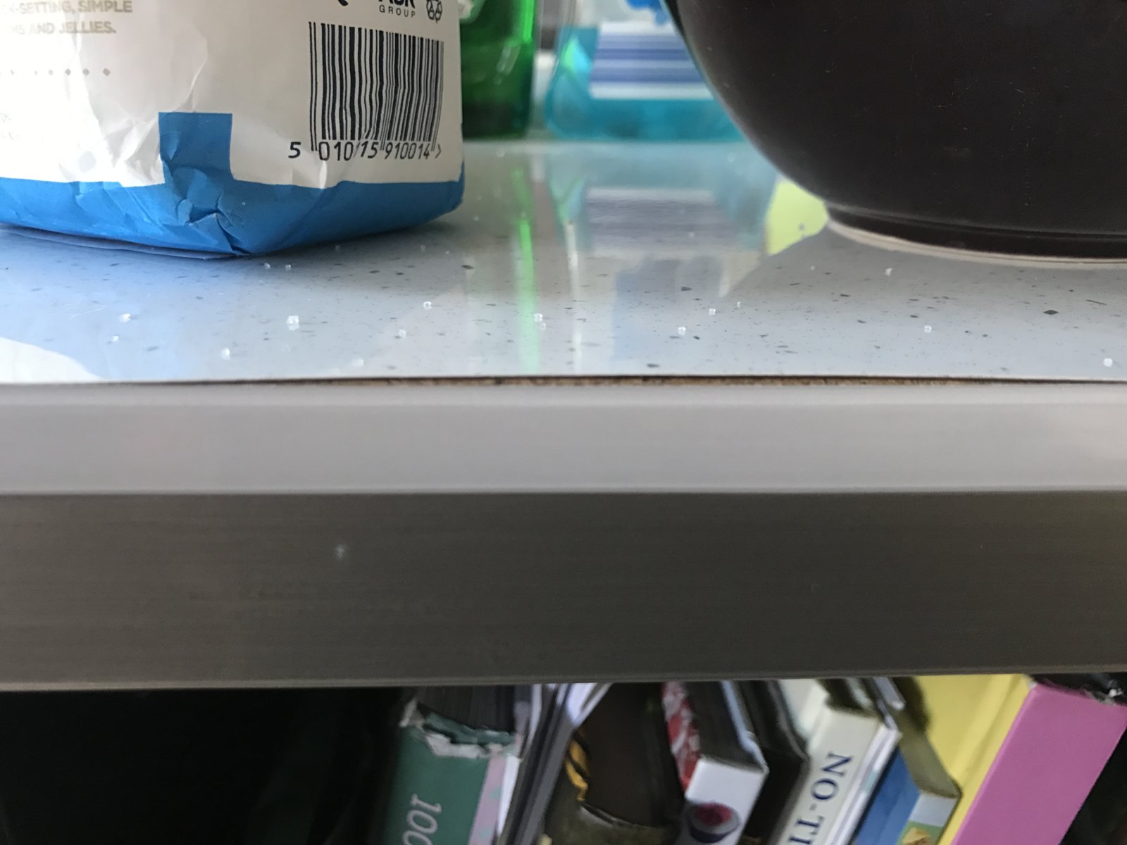

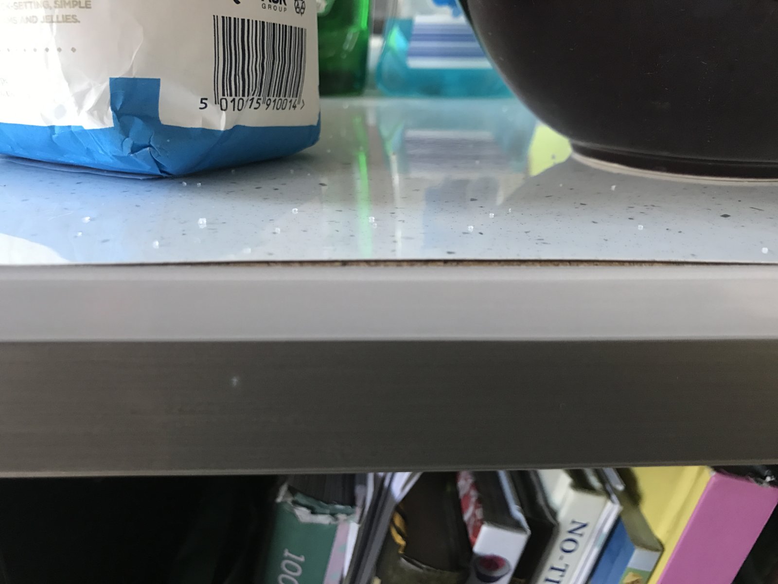

Well let me save you a visit. Plasman worktops, specifically their Artis Bohemian Chrome in Snow (white).
The tops lift and drop randomly and the company ignore e-mails which reminds me, I need to call in there.
Jeez I'd be cutting that off and taking it up there...thats a laminate here ?
