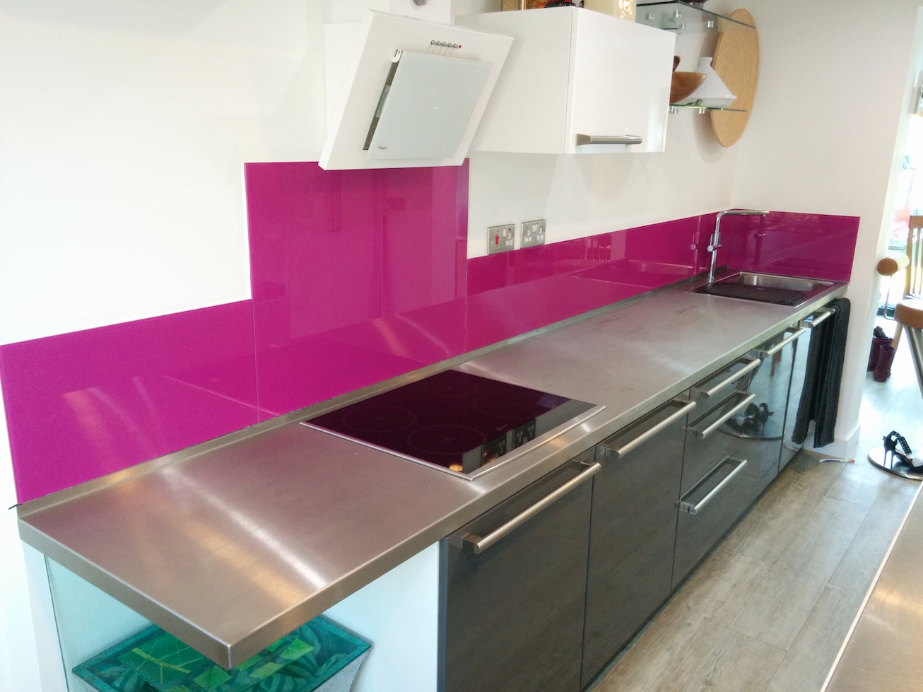

Stainless steel. £450 including laser cut openings for sink & hob.
Fitted over standard 40mm worktop, with 25mm upstand at rear so no silicone/mastic required.
Fitted over standard 40mm worktop, with 25mm upstand at rear so no silicone/mastic required.View attachment 156714
Love the stainless steel. It would never be approved by senior management though! If it was up to me it would be stainless steel and polished concrete all the way.
The backsplash though...
