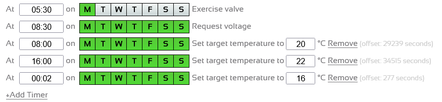

I have hunted the internet, and no guide seems to either cover all, or even get it right. It seems everyone who writes about them has different ideas, but the start of the problem is how to set them.
We see charts like this, which may be a good start, but the problem is, the room temperature is dependent on heat loss with the mechanical head, so with a well insulated room 2.2 may equal 20°C but with a poorly insulated room, it may need to be set over 3, and the lock shield valve also has a bearing to room temperature.
Some systems have bi-pass valves, others rely on one radiator not having a TRV, some systems have modulating boilers, (can adjust output) and others simple on/off. Some pumps on the supply and some on the return, and the list goes on, and not talked about the varying ways the TRV heads is fixed onto the radiator.
So I will start with the valves I have used, and maybe others can add how theirs work, so someone new can read this thread, and have some idea of what they are buying. I would say the mechanical valve does work if the lock shield is set spot on. But for the DIY guy, near impossible to set the lock shield and a mechanical valve, what is wanted is one valve, either the lock shield or the TRV to be set spot on, so the other can be set by trial and error, so *123456 is useless, what is wanted is temperature in °C at least to start with.

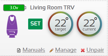

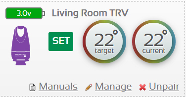

Also, using the target and current temperature report to help set up the lock shield valve. I have four electronic TRV head types (10 electronic TRV heads) and each has plus and minus points, and not linked to price. Some need hubs, others don't, some hubs link to the boiler, others don't, some the hub is also a wall thermostat, others the hub can be at the boiler, some hubs need hard-wiring to the router, other use wireless links.
But the problem is to find out what it can do before you buy. So a post per TRV head type, will help, I don't know what Tado, EvoHome, or Hive heads do today. I do know what Energenie, Kasa, eQ-3, and the old Wiser will do, and I will add to this thread and detail what they can do latter.
