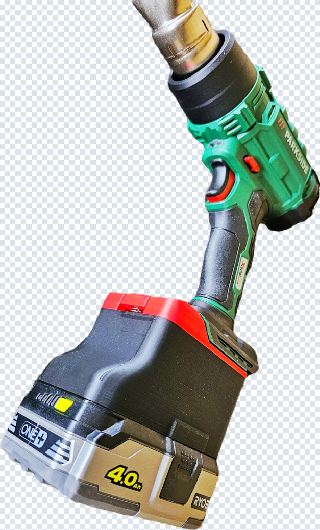

I present, the Ryobi to Parkside battery adapter! Use your [expensive] Ryobi batteries on your cheap Parkside tools. :cool:

Gosh, that adapter's enormous. Why so big? Full of batteries? Or was the design intent just to make it harder to wield the tool in tight spaces
There is a bit of perspective at play there, but Ryobi have kept the battery design with the bit sticking up so the adapter has to allow for that.
All the other manufacturers changed to slide-on batteries years ago.
I certainly would not want to use it on most other tools, but in this case, I needed a cordless heat gun for a specific task and this was the cheapest option

Blimey, someone is selling that adaptor on ebay for £25, although it is available for about £10.60 on Ali Express.

Points taken. The images that I saw looked identical. I therefore assumed that the ebay version is probably sourced from the same people as Ali Express.
Or they are both just using the same image, which may have been 'borrowed' from somewhere else or one of these may have taken it from the other.
I have seen reviews where what was delivered was not what was shown on the website. With a range of reasons, the shade is different (of course it is), the actual colour was different (e.g. blue not red), it is a new model and the website picture was not updated, it was basically a different product intended to do basically the same job.
Oh, well, my Parkside uses two batteries, and they are 20 volt each not 18 volts, so the machine runs on 40 volts. So can't really see how you could ever use Ryobi batteries?
20v is the name of the tool range, rather than the working voltage. The working voltage is the same as others, around 18v.
