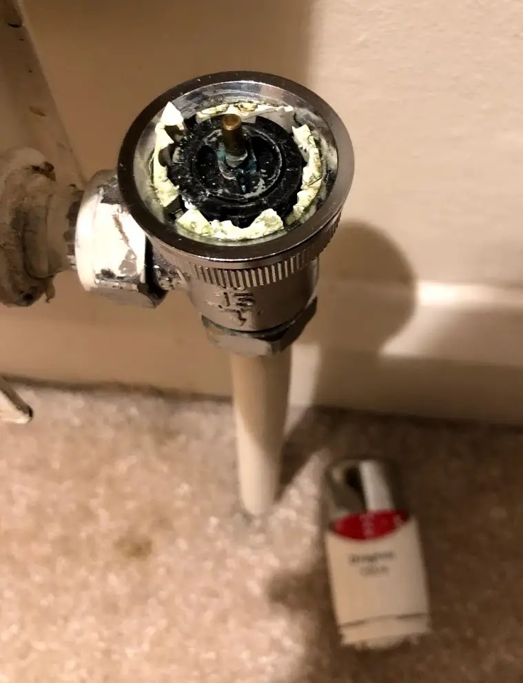

Good morning, I have a question about TRV's in general but mine are specifically drayton TRV4
Mine seem to keep falling, I bought drayton trv4's (7 in total) one failed within a year, another failed after about 3 years, and so on.. I bought these expecting a much larger lifespan. The plastic degrades internally above the screwing in part, then my radiators are basically on max setting until replaced. Just 2 have lasted until 7 years!
I live in the south and I guess its hard water.
I Would like to find a solution to fix this as near to permanently as I can,could you pleae help me acheive this??
should I change to manual radiator valves?
Should I buy rad valves for like £50 each?
Please what can I do?

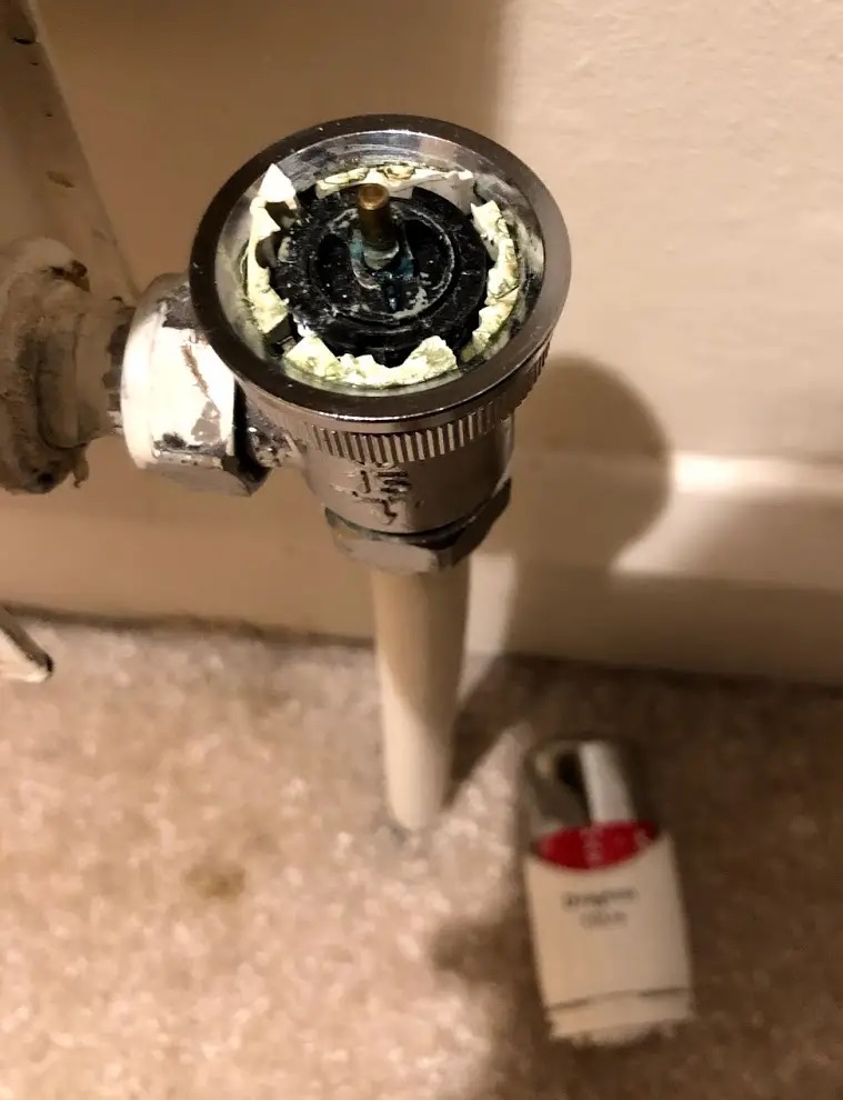

Is it the valve body that’s failing or the head?
Its the internals, as you unscrew the valve head and turn it upside down the first thing i see is that the plastic is yellow and crumbles.
this is whats happening, im not sure of terminology sorry

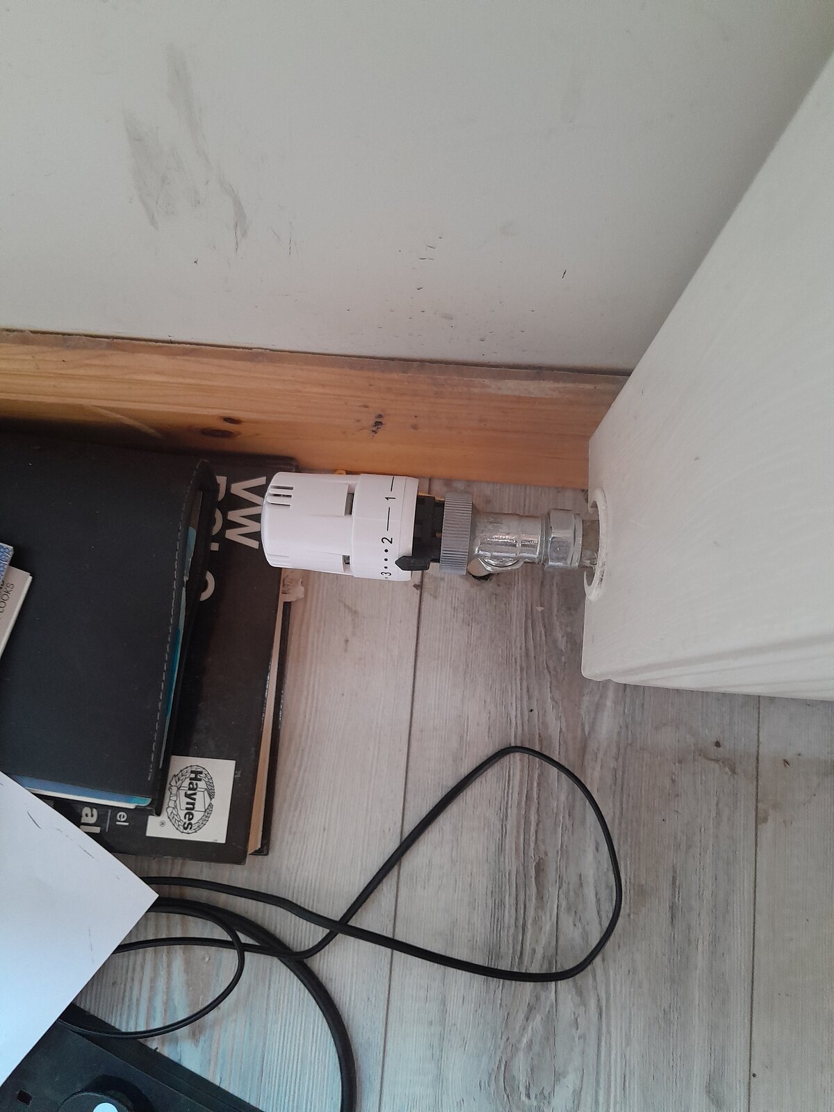

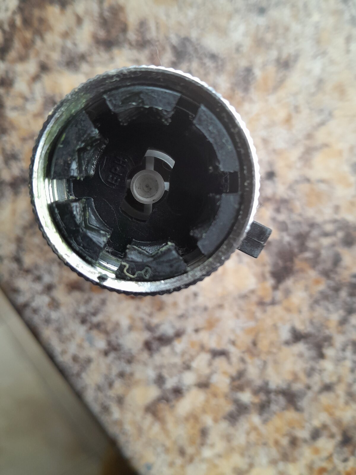

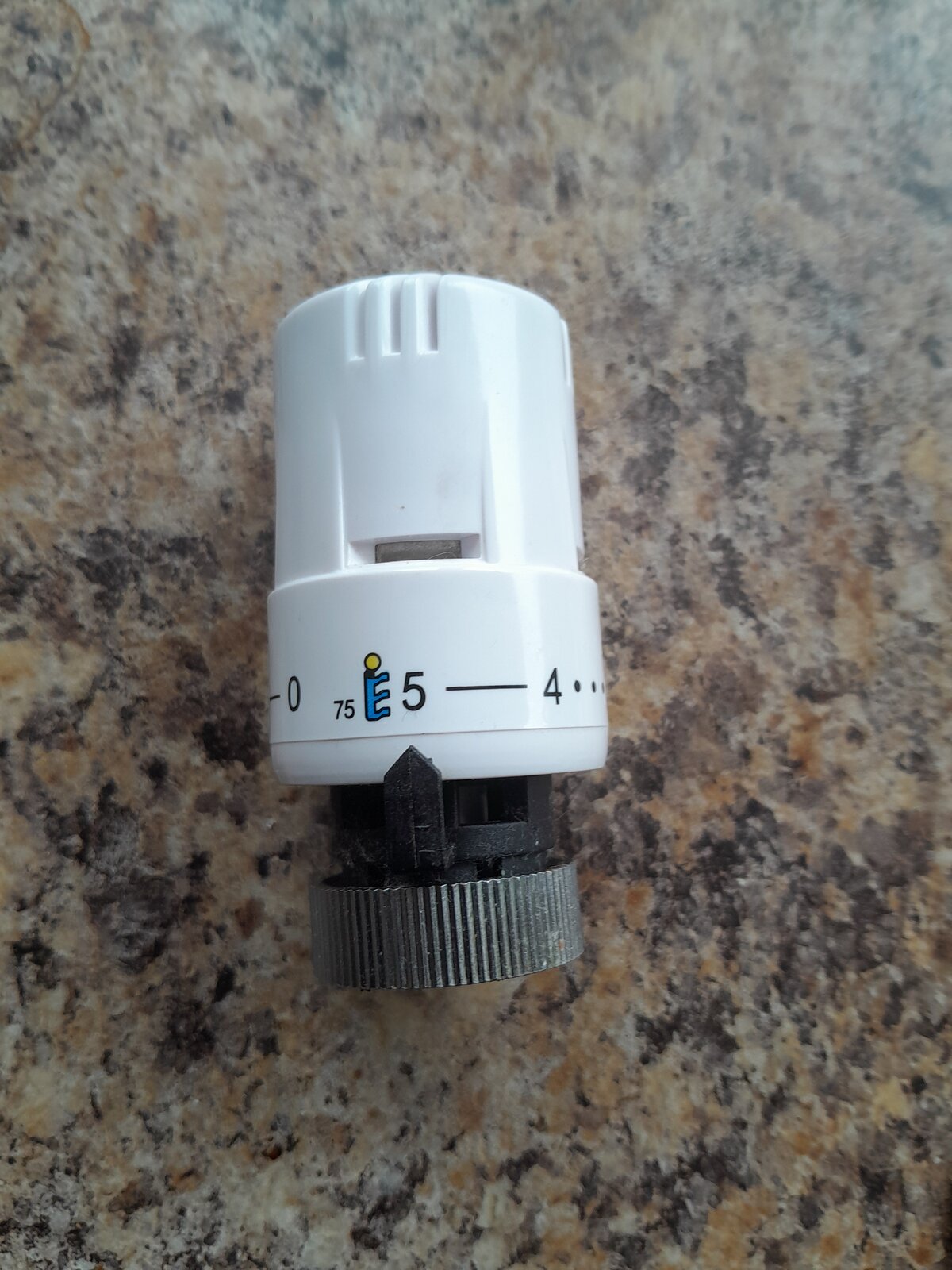

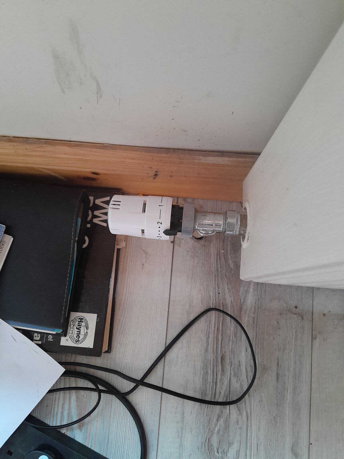

6 year old EPH TRV head below, looks in excellent condition, I allways install mine horizontally on the return as I think it gives a far more representative air/room temperature, even though I didn't install them to prolong the TRV head life, they run at a (water) temperature of up to 15 to 20C lower than the boiler flow temperature.
That's the bottom of the head fallen to bits isn't it? (Rather than the valve body). Agreed a year isn't really acceptable, 7 years is only tolerable. I've been using Toolstation 'contractor' valves with Drayton Wiser heads- been in 8 years now, no problems. The TS heads look quite robust, you could do worse...
