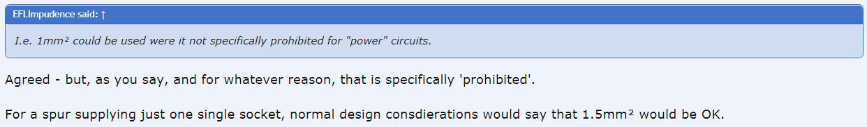

Possibly, but I would say that ", with or without unfused spurs," separated by commas means that the spurs are separate and not being considered.
As I said, I think that it is 'open to debate'
Yet, it only states that while showing 2.5mm² conductors - which could handle two single sockets.
Yes, but only if the CCC were 26A (i.e. Method C) - which is why I was wondering whether (per above) they were talking of a situation in which CCC was permitted to be as low as 20A (as it certainly is for the 'ring' cable).
Yes, but 1.5mm² has a CCC of 20A, anyway.
It does (for Method C) if you look at 4D5 - 4D2A says 19.5A :)

However, as one thought ... if one thinks, as I suggested one might, that what 433.1.204 says about cables applies to unfused spurs as well as the ring itself, then not only would the spur cable be permitted to have a CCC as low as 20A, but it would also be required (unless MICC) to have a CCC CSA of at least 2.5mm².
Why look at 4D2A? Anyway, I am sure you would not quibble about the half an amp when the load is 13A maximum.
Quite - as I said, 1.5mm² cable would obviously be more than adequate for one single socket - it was you who commented that it would (if Method C) "have a CCC of 20A, anyway" (even though 13A is all that is needed)!

Indeed - and seemingly a particularly weird anomaly! It's hard to see why they felt the need to impose a minimum CSA as well as a minimum CCC - particularly given that, as we've been discussing, a cable with a lower CSA than their 'minimum' could (if one looks at the appropriate table in BS7671 :) ) satisfy the CCC requirement!
