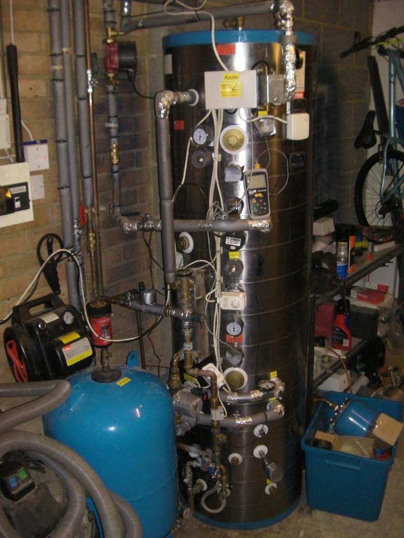

thermal store temperature low when CH on & limited HW

OK... Here is the charts from a little testing. You owe me two stores worth of water, gas and salt.
From a cold start, we were on after 30 seconds and switched off at 17 minutes.
Bear in mind, (I assume) due to the way stratification works, my store always shuts down fairly quickly form a cold start.
After this period, I let it settle down and then, ensuring no heating could come on went for a long shower.
Water off the plate was blended to 53 degrees. The shower runs at 11 l/min (thought it was higher actually. Must get a bigger shower head).
The shower lasted 13 minutes, but started 60 seconds after the graph started plotting. After 10 minutes I cranked the shower up to about 46 degrees, not sure what the cold inlet temperature of the plate is though sorry. Boiler shut down after 26 minutes:
Then the missus had her shower. For this I cranked all the rads up to max at 30 seconds. She started showering at 2:51. The boiler kicked in at 3:40. She finished in the shower at11 minutes and I switched the heating off at 15 minutes. At 17 minutes, for some womean reason she blippe dthe hot water. The boiler shut off after 23 minutes.
Now, the Hot water draw off to the plate is at the same height in the store as the boiler flow and my measurement point. The plate itself is seated just above the centre point of the store. the rad flow is somewhere between the two. In theory, with no draw on either heating or hot water, my plate draw off static temperature should be the same as the centre store temperature.
The boiler return is a little above the heating return; and the store temp sensor is a little above those.
No stupid coils involved. As advised... get the boiler taken out of the equation. It is killing your performance and efficiencies.

I can only thank you for the effort you have put in to record your thermal store operation. I do appreciate it :D :D . Your graphs are nothing like mine and prove how the thermal store should work. Your thermal store looks more like something destined for the ISS space station than something residing in a garage. No wonder it works, it looks like its been built by NASA :LOL:.
Anyway back to business. The guy from Ideal boilers was in. After showing him the data and him having a root around he was pretty adamant that it was crud covering the thermal store coils. The boiler is just protecting itself when the return is nearly the same as the flow. He has seen something similar with the same setup. Although he did say we could reduce the flow, it was more of a band aid. Best course of action was to put some x400 in and let it act for a while then put x100 in.

having looked at the graphs it shows that the coil only has about 8 degree differential.
This would indicate that the flow arond the primaries is fine but there is a problem with heat transfer in the thermal store.
I often see the reverse in gledhills with poor hot water performance.
I would recommend that you take a sample of the stores water to see what the ph value is.
I am guessing that this will be much more alkaline than you would expect and because of the store generally being above 65 degrees has scaled on the outside of the coil preventing heat transfer.

So I had x400 in the thermal store for 4 weeks. It made no real difference.
I had a heating engineer out today to remove the immersion heater so we could have a look inside the thermal store to confirm that it is the coil that is furred up.
The link below shows the state of the immersion heater that was taken out
//www.diynot.com/network/thermostorebore/albums/
It was covered in black oxide. It was really well adhered as well. I put some x800 directly on to the coil. It didn't really move it at all. The picture shows some copper exposed. Inside the cylinder the coil is caked in black oxide and so is the sides. Hardly any copper exposed.
Now that it is confirmed what it is, the next question is what to do about it.
I have tried closing off the isolation valve on the return of the boiler to 3/4 shut. It didn't really make any difference, no wonder having seen the state of the cylinder.
My next port of call is stronger chemicals. Has anyone used Fernox DS40 successfully to treat black oxide like this. This really is the last chance for this cylinder. Does anyone know of a better product.
