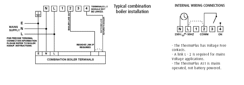

I am trying to make a training setup to teach users how to program a Thermoplus AS1. I have fitted it to a portable box and it works fine on its own, BUT I want to connect an indicator light (230v) to it so that when the heating would be on the light will light up. However I am having no luck with this.
Does anyone know what terminals the light should be connected to.

Link wire between Live (L) and Com (2)
Live on indicator lamp connected to On (4)
Neutral on indicator lamp connected to Neutral (N)
....though this might be something you really want to understand, if you are training people in its use!
....and PATest it!

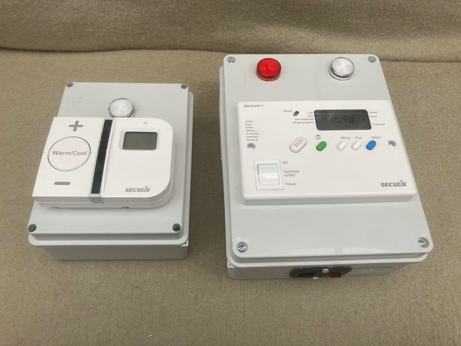

I work for a housing association, and we have a large variety of different controllers. One of the biggest issues is tenants who cannot set them right and we get many maintenance calls that are just due to not knowing what to do. So I have built a training setup for each type of controller (pic of 2 samples attached) so our staff can familiarize themselves with each one and how to set it so they can demonstrate to tenants easily. Or even take the training box to them and let them practice without possibly upsetting their real one. We have over 1300 properties and about 8 different controllers. Each training setup is connected to power with a removable kettle plug lead.
