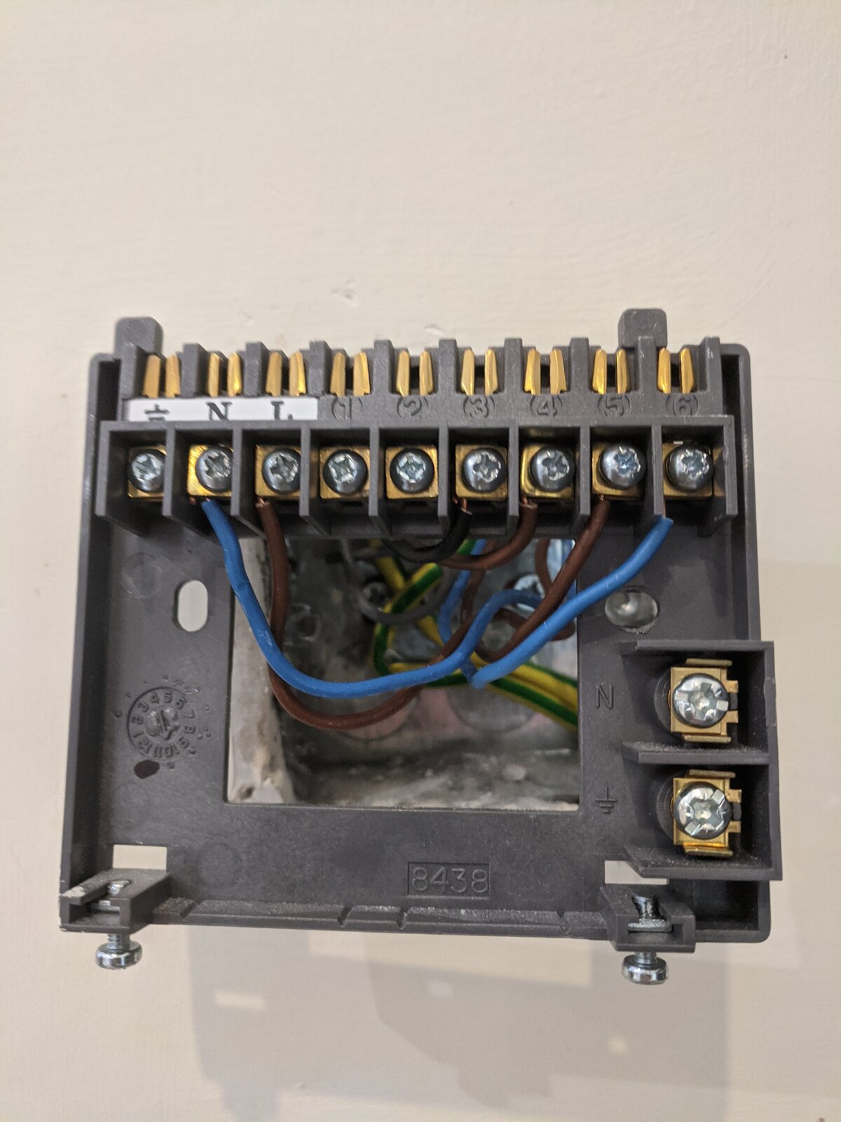

Hello
Can anyone help me ? i need to replace danfoss is 9000 with new curv trv02 and i don't know how to connect
Hello
Can anyone help me ? i need to replace danfoss Tp9000 with new curv trv02 and i don't know how to connect

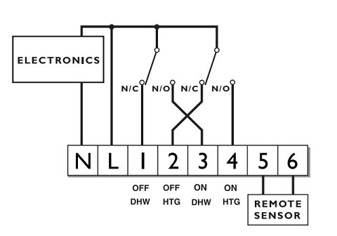

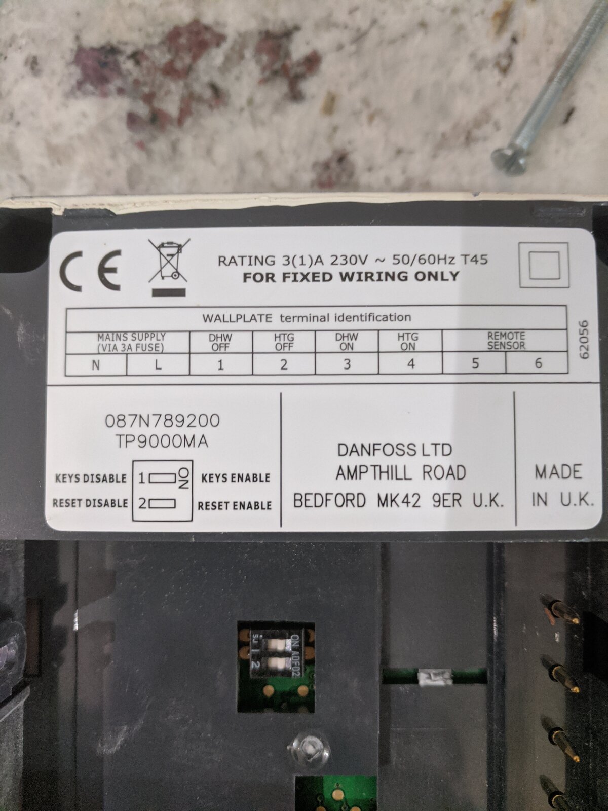

Based on the diagrams below, the remote sensor is disconnected and removed from the TP9000 and the remaining wires are simply moved from the TP9000 terminals....
TP9000

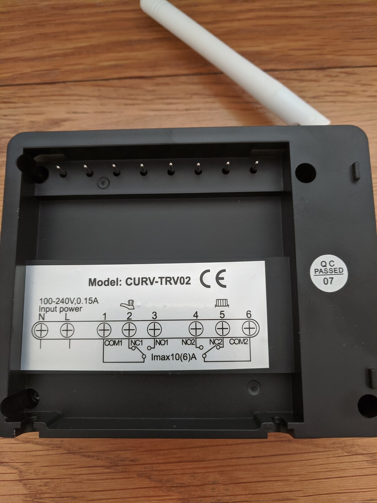

....to the CURV terminals that have exactly the same function. [If your CURV has different connections from below, don't proceed and post back details]
If it is as above:
TP N = Curv N
TP L = Curv L
TP DHW Off N/C = Curv NC1 (maybe / maybe not used depending upon your system)
TP HTG Off N/C = Curv NC2 (probably not used)
TP DHW On N/O= Curv NO1
TP HTG On N/O= Curv NO2
Add a link between Curv terminals L, Com 1 and Com 2 (the TP has these connection already made internally)

to be sure I am sending photos,
