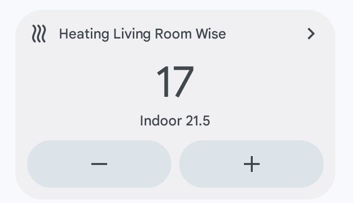

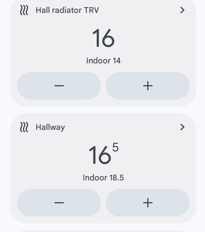

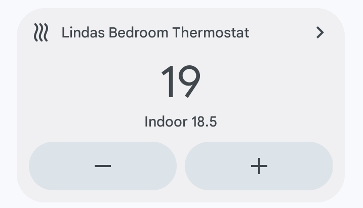

With Wiser, I need my phone, at least to program it all. This is what we are looking at 1743949391534.pngthe wall thermostat bottom says hall is at 18.5ºC and the TRV says hall at 14ºC. The wall thermostat is higher, and closer to the centre of the house, the TRV both lower, and likely in the draft from the cat flap. So the command "hey Google set hall to 16ºC" will set both to same temperature. Nothing will happen as wall thermostat showing 18.5ºC, unless either the living room, 1743949936159.pngcalls for heat, or bedroom calls for heat 1743949999114.pngso it all gets rather complex.
However in my house, the TRV is king, I have 10 electronic TRV heads, which are programmed as to when each room is heated, it still needs a linked thermostat either of the two wall thermostats or Linda's bedroom TRV head to start the boiler running, but in the main rooms are controlled by the TRV heads.

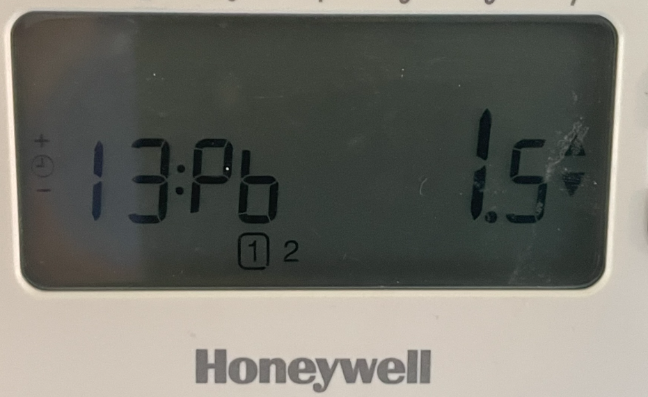

They are the default settings, also check Cycle ratio 2:Cr, it defaults to 6 (cph, cycles per hour)
Even though it doesn't state it, I would think that controller has TPI control, normally, these controllers will demand continuous firing when the SP/flowtemp dT is 1.5C or greater (with your setting of 1.5C), once the dT is less than 1.5C then the TPI control takes charge and cycles the boiler on/off until it reaches a practically zero dT.
So, what is happening now with that controller, have you checked that the boiler is actually running when there is a indicated demand, get the boiler to fire one way or other even if you have to increase the SP to get a > than 1.5C dT, then see what happens?

I think you said that if you increase the required roomtemp (in the morning) from 17.5C to 18.0C? or whatever, that the boiler fires and the room then heats up?, obviously not the way that you would like it to perform though.

Understood, but if the displayed temperature is within 1.5C of the required (setpoint) temp then the boiler will not fire, so if the required temp is say 17C and the displayed (actual) room temperature is 16C then the boiler will not or shouldn't fire because of this, it should fire at 15.5C or very slightly less, the question I asked was if you increase the required temp to ensure a difference of 1.5C or slightly more does the boiler then fire, as it should.
Ok- understood… now.
I will test this. This makes sense, I will increase it slightly tonight to test.
