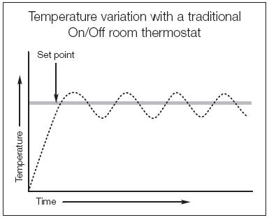

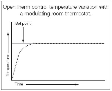

Very concisely put, in Uni it was called a mark/space ratio. And it produces a graph like this Temp_variation_on_off.jpg however with the modulating boiler the TRV does all the work, and is analogue, not digital, seems odd that in this case analogue (up/down) is better than digital (on/off) so we get Temp_variation_OpenTherm.jpg graph.
The problem is some analogue wall thermostats don't integrate with the TRVs. With the likes of OpenTherm we can select a thermostatic control to suit the home, my old open-plan house would work fine with Nest, the house however has things called doors on the rooms, so need linked TRV heads to control multi rooms.
