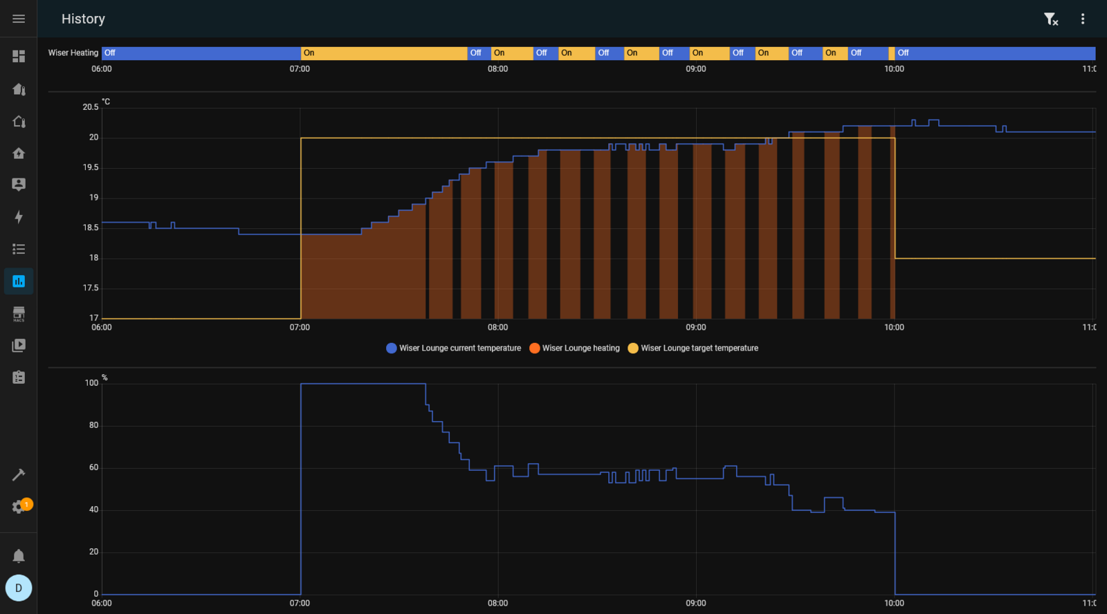

The Wiser algorithm is a bit of a mystery to me so I have attached a screenshot from yesterday between 06:00 and 11:00.
There are 3 graphs, the first is the boiler firing as requested by the Wiser hub, as you can see there are 3 cycles per hour. The second graph shows target and current temperatures, the orange bars are when the thermostat is requesting heat. The thermostat appears to also work in cycles however its is 6 cycles per hour. The third graph shows the heating demand.

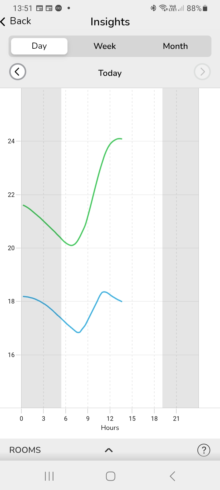

Me as well, but don't know where that screenshot you show came from? Insights? I get this 1744375926077.jpeg showing two rooms with Wiser thermostats, and how the temperature has been, boiler not running today, but not found anything like this 1744376051121.png I was a little surprised when I saw:-

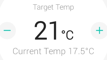

Probably time for a new stat, the only strange thing is what I mentioned before where (maybe on the other site you posted on) the set point temp was 17.5C and the indicated room temp was 16C with a boiler (flame) symbol demand displayed on the controller so the boiler should have been firing at this stage, did you notice this morning if the demand symbol was displayed?, if you didn't look for it, maybe check it tomorrow morning and if it is displayed check whether the boiler is firing or not or just firing intermittently.
