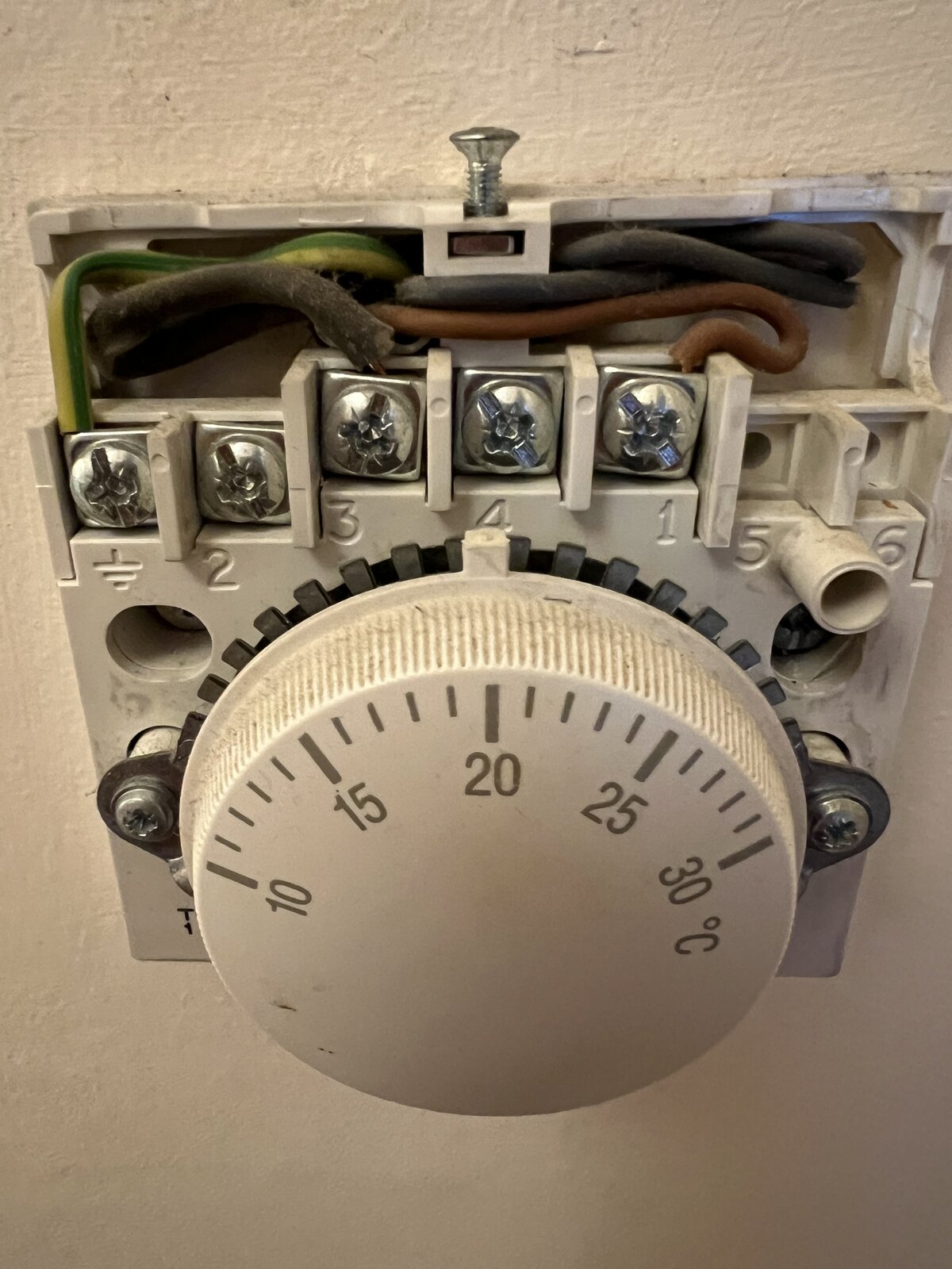

I came across this post after a Google search & also need advice on which smart thermostat I can use to replace my dumb Honeywell unit (same unit as pictured above).
I’ve had Nest in a few houses but I’ve found that my current thermostat only has 2 wires to 1 & 3 (plus an earth) so I’m guessing I’ll be limited to a Nest-e.

As you have correctly figured, there should be a neutral connected to terminal 2, and as it's missing, the existing thermostat won't be working as accurately as it could.

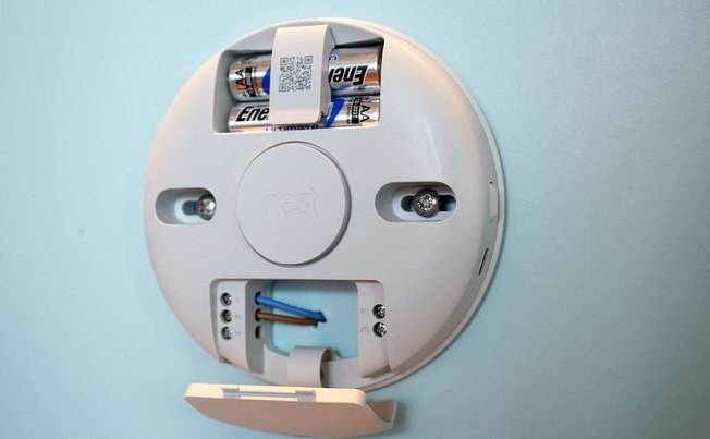

Nest E is battery operated and so doesn't need a neutral. It comes with the Heatlink and that's where the two wires that are presently in terminals 1 and 3 go. No wires are connected to the remote Nest E Thermostat itself. The thermostat communicates with the Heatlink wirelessly.

In your photo of your existing thermostat, there is what appears to be an unused wire, if you can find the other end you may be able to connected it to a neutral that is part of the heating circuit and install a 3rd Gen Nest. Provided that you don't have to access any room sealed part of the boiler that is part of the combustion chamber to access it.

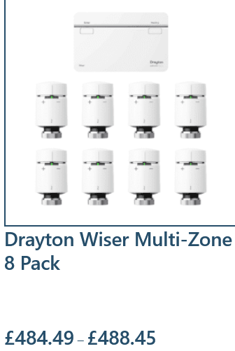

So the Wiser as an example 1728390798464.png the hub to left comes as three versions, the three channel 1728390917120.pngwill work two zones for heating and one for DHW, the two channel will work one zone for heating and one for DHW, so even though you don't need control for DHW likely you would still need the three channel version.
Or combine both zones together, and once you have programmable TRV heads, no real need for zones, so the stumbling block is the price. 1728391228774.png£488 takes some getting back in reduced gas bills, the hub would go next to boiler, and the existing zone valves would work together or could be removed, but as said, I have just got a single zone Wiser because areas of my main house were not getting to temperature required before the hall wall mounted thermostats switched off. So not got to save money, got for better comfort, but I have oil not gas, and big difference is oil does not modulate, that is turn down output.

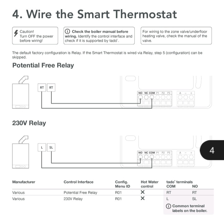

If your existing thermostat is in a convenient position, the Tado smart 3+ "Wired" thermostat is a battery powered thermostat; it will replace your existing stat, without needing a neutral connection.
This looks interesting. So I can use a Tado Wired unit to replace my wall thermostat unit with no need for anything else to be wired to the boiler. If so, that’s the route I’d prefer.

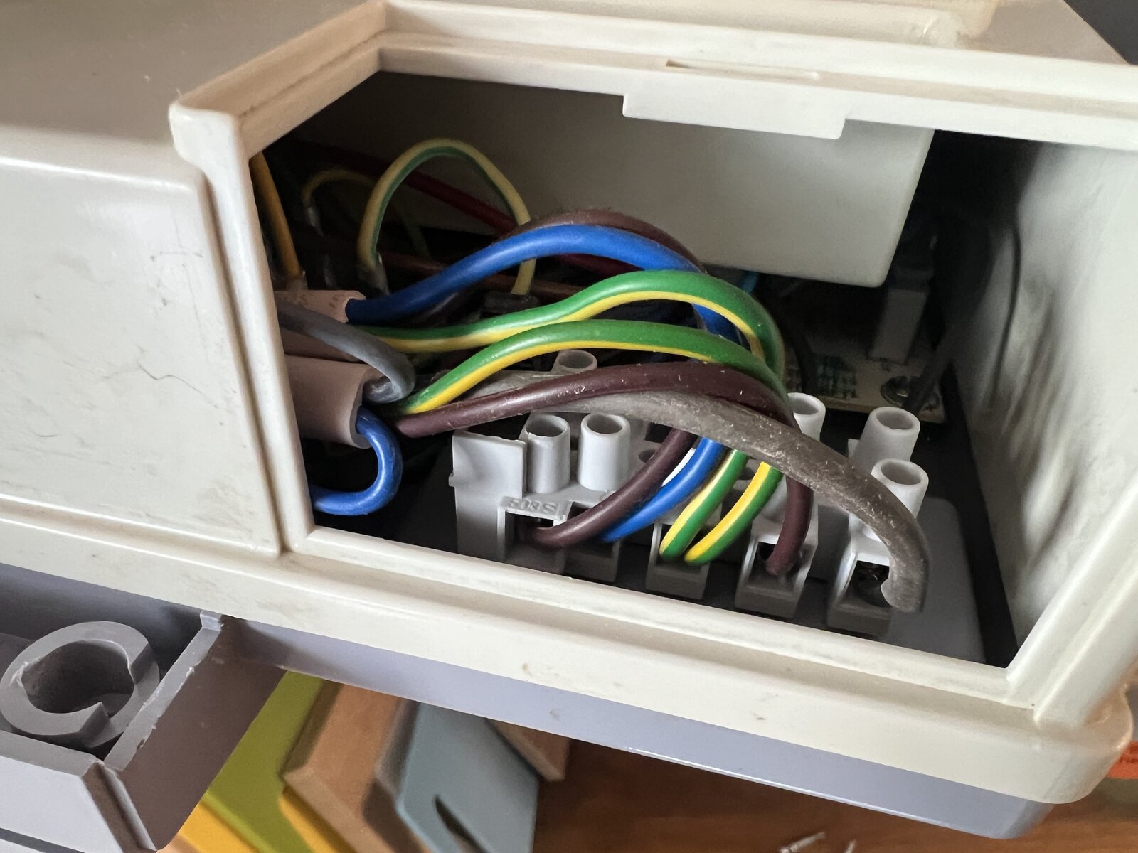

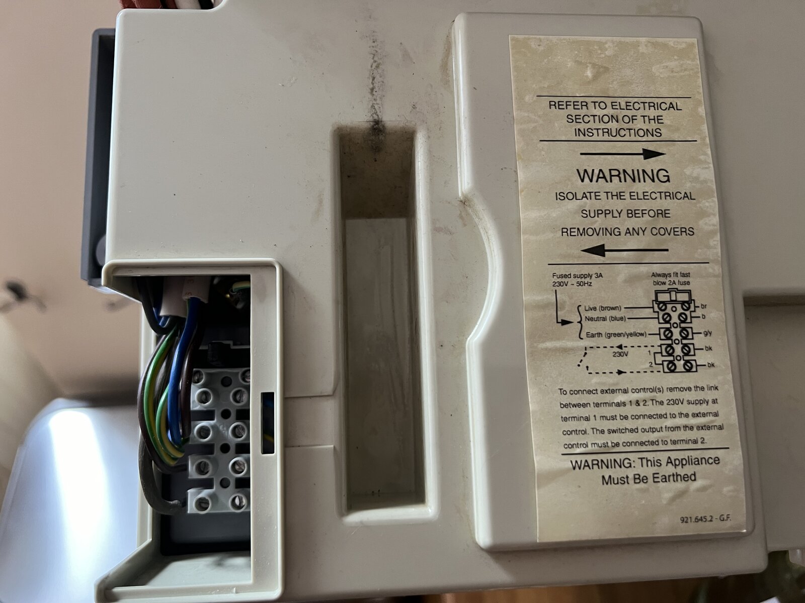

Here’s the wiring I found inside the boiler. Haven’t tested yet to see if one of the neutrals connects to the thermostat, but my guess is that it will.

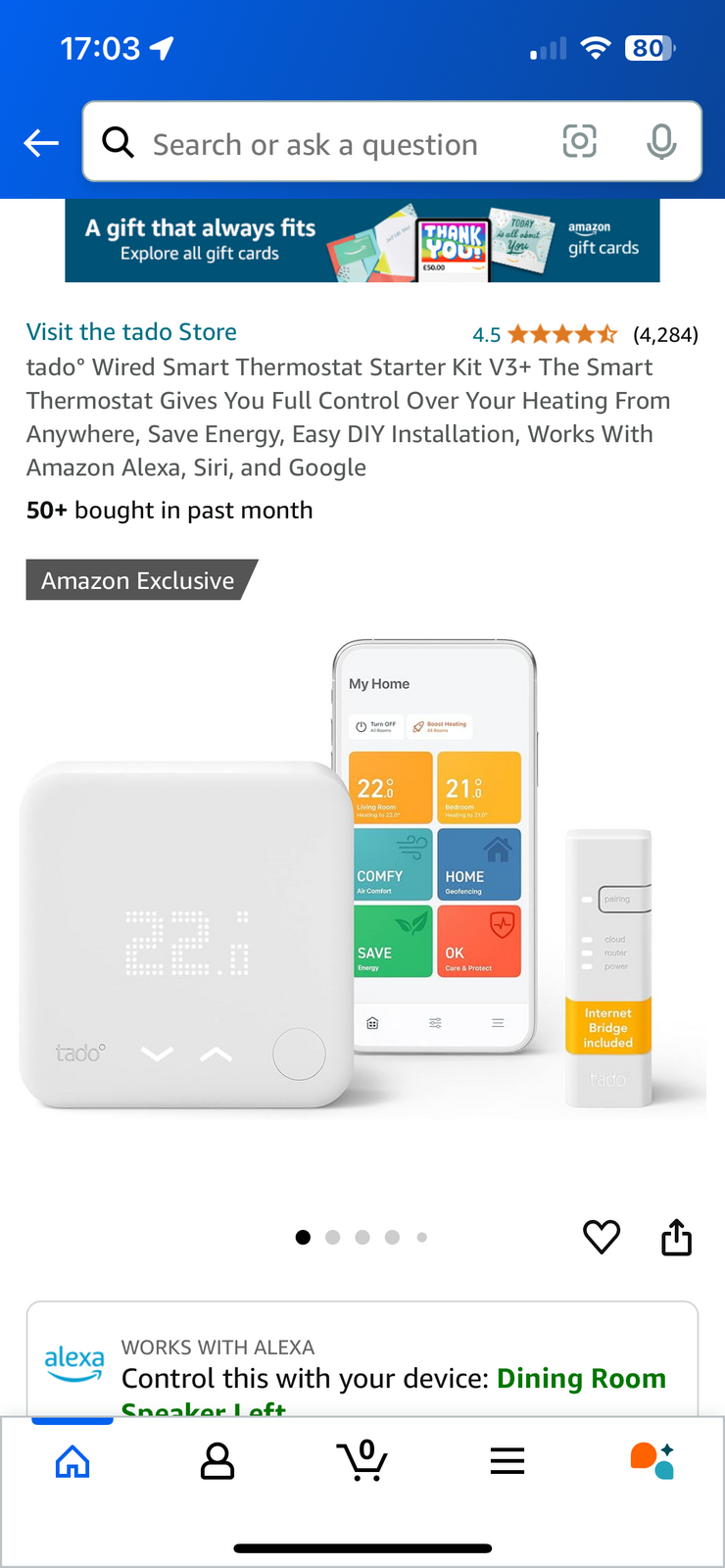

PS - the Tado wired is 50% off on Amazon Prime day here in the UK right now which is one of the reasons why I’m interested in it.
Yes, simply connect the wires in terminals 1 and 3 of your current thermostat into Tados terminals NO and COM - which wire goes into which terminal isn't important.
However, it appears that you do have the required wires spare at the boiler, to provide a neutral to the thermostat, if you wished to have a mains powered unit.
